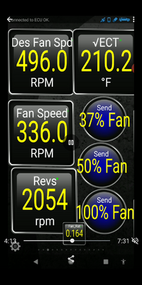

So a couple days ago I swapped my previous junkyard EV fan clutch for another. This time a Behr unit. The original as well as the previous unit never went below 720 rpm and ran about 1200 rpm at 2000 engine rpm. It otherwise worked when commanded so never an overheating concern.
I first tested this second junkyard pull for speed sensor operation and resistance through the solenoid. This unit registered a significantly lower resistance of 8 ohms, the previous having been 12 ohms. Either way the resultant amperage seemed to be reasonable. I could hear the solenoid click so I knew that much looked OK before doing the swap. After the swap I tested it out in the garage and it engaged as it should and appeared to disengage much like the previous units did, remaining at roughly 720 rpm at idle. I thought "well it's no worse and it gives me more of a data sample for consideration".
Today I am headed out for the first time on the road with it and upon starting I see the fan RPM in Torque at 174!! I pop the hood for a look and sure enough it is just loping along. I have never seen a fan running that slow without having been manually stopped by hand during a test. Have now driven about 30 miles in two legs and this unit seems to disengage better that my previous units. At startup I get a couple hundred rpm and it stays fairly low for several minutes even after having accelerated to highway speed and maybe 1800 engine rpm. Eventually it goes to the same 1200 rpm at highway speed and close to 2000 engine rpm. The tipping point seems to be in the mid 300s. Once it lopes on up to that it then seems to re-engage more fully.

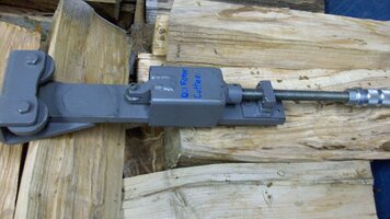

Built a smoke machine to find a possible leak
I have thought about doing this. Have collected a fair amount of electric heater element (wire) from old residential hvac units. Planned on using a gallon metal paint can but then saw where someone used a glass vessel and mounted the heater stuff in the lid. Might try that.
Ironically that's what I did. I salvaged a heater element from a furnace and a valve stem from a tire. Gonna try it soon.
That looks like a hot surface igniter there. I plan on using some resistance wire from an electric heater element. I have some from a furnace and also some from an electric clothes dryer.

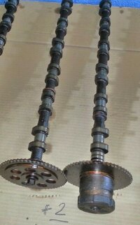

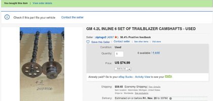

While looking around for some Camshaft Aluminum Cap 10.9 Fasteners on eBay for another GMTN Member... I spied a complete set of Used GM 4.2L Cam Phaser, Intake Sprocket and both Camshafts for $58.65 (plus a fairly big hit on the S&H) and so I've have this set coming,
Ordinarily, I would look for All New Valve Train Components, but since I need to R&R the Camshafts with Galled Ramps and Lobes on the Cams fastened to a 2004 Engine Head... these should do nicely. I think this eBay Vendor also has some additional used Cams and Cam Phasers for anyone working on a Weather Exposed Motor that has the Top End Rusted Up & needs any such gear for an R&R:
@MRRSM , I wouldn't reuse that phaser. It looks a bit coked up, just like mine was when it failed, which tells me poor maintenance.

@Mooseman ... THAT Exhaust Camshaft Phaser is going to take a Nose Dive into a Nice, Deep Bucket of Berryman's ChemDip as an Experiment in "How to De-Gunk a Helical Cam Phaser, Circa 2002-2003".
I'll be fabricating a "Slender Bathtub" made out of Cardboard and Duct Tape and then after lining the interior of it with a section of Plastic Garbage Bag... I'll submerge the Camshaft in there under some more Berryman's Chem Dip for nice, long Bath; one at a time to De-Grease, De-Gunk and Clean Up both Camshafts as Prep for a later Bright Light Inspection,
Then, I'll Spray all three items Down with WD-40 after a Wash in Hot Water and finish the Jobs with separate Saran Wrap Ups of them. The Old TTY Bolts will go into my Old Junk Bolts Bucket for other Jobs... :>)
