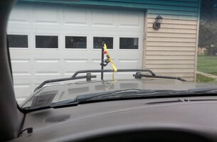

The brush guard project continues. The mounts are probably about 75% complete. They mount up as expected, so now I just need to make some minor modifications because I don't like the way the hardware attaches from mount to guard (and my measurements were a bit sloppy anyway so this change will help disguise that).
I think I'd like the hardware to line up vertically now, not horizontally as it would with the OEM's mounts. IMO that will make the mounting stronger.
Hopefully I can get this done before the end of the month... Every time I test fit this I think "man this will be cool when it's done".

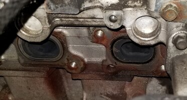

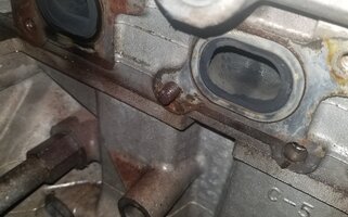

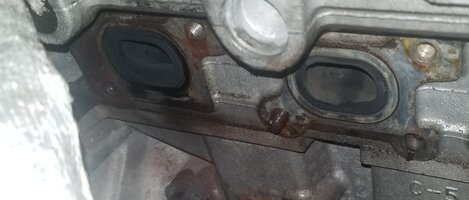

Started the exhaust manifold swap. There was two broken bolts before I started, I was lucky with one of the broken bolts with enough room for vise grips.
The rear bolt is recessed but somewhat flat, so getting a left-hand bit started should hopefully go well.
Looks like #1 & #6 had a leak, going by the larger amount of soot around the port.

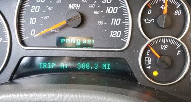

My first full tank top-off today since I replaced my exhaust manifold. I finished the manifold Monday AM, then filled the tank Tuesday.
I didn't think I had much of a leak, if any....but that tiny leak could have been contributing greatly to my reduced MPG.
In the last couple years, I would sometimes manage 270 miles per tank at the light if all conditions were perfect...and that was rare. I've been averaging about 14-15 MPG combined since the start of winter.
I drive about 30 miles each way to work, probably hit 10 red lights, add in some short trips to the school and soccer fields.
Today, I was quite surprised at this...
Total fuel was 16.5 gal so the actual was about 18.5 MPG
....not bad with mixed city/hwy....esp with the 4:10 ratio.
This was up from about 250 miles at the light the last maybe 10 tanks

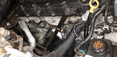

Patched the exhaust leak where the plates bolt together after the cat. The one flange is worn so i been patching it here and there. Should just weld it one of these days.

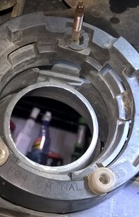

Changed the fog light assemblies because the old glass was in terrible shape; mostly because of 132K miles in the rust belt and 67K in this area. I had previously installed some Phillips LED 6200K bulbs and it was just.. not what I had expected. After looking at the lights.. I ordered 2 new assemblies from Rock Auto. Needless to say it was a pain getting the old assemblies out. I used washers to hold open the 2 small clips at the top and had one *)*)&&^%% of a time getting them out. Basically after take the bulb/lens assembly out the 3 bottom ones were NOT fun.. again it made me wish I had a lift so I could standup instead of being on the cement floor. And yes I use some cheap Harbor Freight foam pads under my ramps to keep them from sliding on the smooth slick garage floor. Before the new assemblies the bulbs didn't even light up the sides of the bezel.

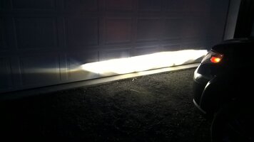

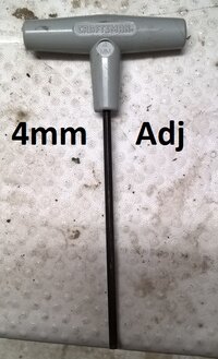

When it gets dark enough here.. I go out and adjust them.
Fog Lights now aimed .. pictures below. Took it for a test drive.. first time I've been able to tell when they're on.. well on the road not just on the DIC.
