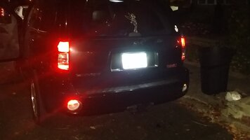

Installed ascender taillights on the voy. Very happy and so is the wife.20161108_201052.jpg 20161108_201833.jpg
Unfortunately I'm getting hyper flash with these damn red leds in the turn signal. So I'll be ordering that flasher module for leds.

Is this just a plug and play fit? Which one did you get?
I had to just tap the wires together. Not sure if @Matt had to do the same cause my connector was different since it's an 08. It's actually for the 07-12 avalanche but it fits our swb 360's.
Mine is an '05 I wonder if that matters. I'm not real sure about doing things to the wires idk what I'm doing haha
On my 02, we cut the plug off the old light and put it on the new one just to make it easier to remove if need be.
