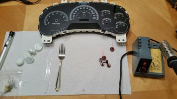

Speedo was done a few years ago,...oil, temp, & volts all started acting up within a few months of each other so I replaced all except the speedo this time. The tach motor was a pain as one of the traces lifted...but all is good now.

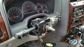

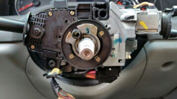

As for me, earlier this week, I've been noticing a seemlingly random rattle in the passenger door, so decided to investigate. The inside handle seemed firm, but when poking around the edges looking for maybe a broken/loose clip, I came across this... :eek:
I think my friend, last weekend, closed the door by grabbing the top of the panel and somehow pulled the lip out of the channel. Figured while I was at it, to go around the other doors, and sure enough the 2 driver's side doors weren't well seated either. :hopeless:
This reminds me, I need to get new door handle bezels, stupid broken clips bug me. :mad:

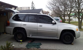

Stretched out the 4x4 legs. Nothing too deep for street tires.

Added an extra 3/4" to the rear, since perfect level just wasn't looking right in 99% of real life scenarios. Wheel spacers went on as well. Much better. Rear sway links are hammered, brakes aren't lookin too sweet back there either. Sounding like a bad bearing up front (spacers should help accelerate that issue, ha) so looks like I'll be going back in sometime soon!
