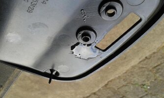

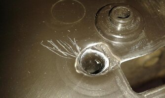

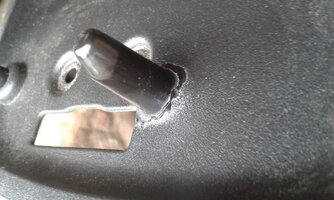

Super bonded and stuffed the center console lid pin with epoxy resin. Was going to add unidirectional carbon fiber to the inside of it to add strength, but did a whole mess and ended up just with the resin.
Super bonded pin:
View attachment 32577.jpg]
Scratched the surroundings of the hole to give the resin some grip:
View attachment 32578.jpg]

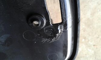

Stuffing the hole:
View attachment 32579.jpg]
View attachment 32580.jpg]

To make sure the hinges haven't been misaligned so the latch will work.
And to ensure the console lid makes creaky noises :tongue:
