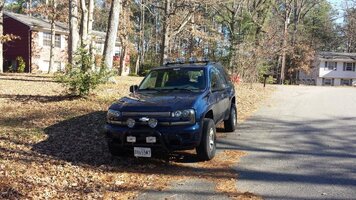

Darkrider_LS said:
Did you do the cap mod or drl killer mod?
I did the cap under the rear seat. I like that the lights are 100% unless I use my dash switch to turn them off. Also have quad beam mod so they dont turn off with the highs.
Installed the light bar yesterday, I am having a grounding issue with the 2 on the outside and it melted some wires before the fuse blew. The center ones are fine. Still need to align the after I figure out the problem, but holy crap these things are bright.

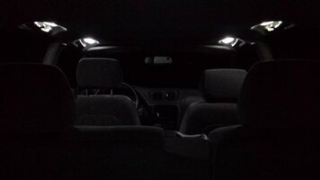

Finally finished my LED install.
Outside the cab; the brake, tail, rear turn, reverse, side marker, and front turn lights are all LED. The front turns are switchbacks.
(My license plate lights aren't LED, but they're no big deal)
Bright!
Amber for the turn signals
White for the running/parking lights

How many 194s do we have on the vehicle? Also is that what the domes have in them?
I also just realized my front passenger powered switch button illumination isn't working. :frown:
Venom I'd answer but last time I counted three times before buying and I still ended up with extra bulbs by accident. It's a mental block for me or something.
I have eight 194s inside and two 194s in the side marker lights, the license plate lights are 2825s according to the guide I'm using.
10 total.
All of the map lights take 194s, the dome light (in the cargo area) takes one 212-2 bulb.
(2005+ Trailblazers have different interior lights)
2825 and 194 are basically the same thing.

I have an 02 so I will try and count mine today and see.
gpking said:
Since they both fit the same socket, an '02-'04 Trailblazer takes 10 white 194s and 2 amber 194s.
I take it the two ambers are for the front side area of the headlights or sidemarker area?
I counted (12) 194s and (1) ??? near liftgate in roof.
2 headlights, 2 floorboard areas, 4 in roof over front two seats near handles, 4 in roof over rear seats near two handles, and one bulb I that I don't know over the hatch area.
If it helps I have sunroof setup.
That's a 212-2 that goes in back there by the lift gate.
The map lights (above the seats next to handles) take 8 total, the lift gate dome light takes a 212-2, then the license plate takes 2 more 194s and the marker lights (side of the headlights) take 2 194s also for a grand total of 12 194s and 1 212-2.
I don't have any floor lighting in my '03, so that might be something you need to investigate on your own.
