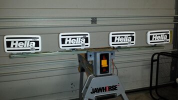

On a note more on topic I started doing the mounting of the lights and wiring. Just doing the rough work till it dries and I can sand and paint the rail.

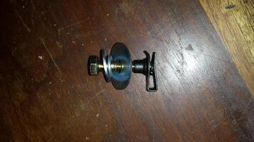

I am also trying something a bit different for mounting the rail to the oem rack. Using blind u bolts to slide into the rails and 5/16-18 bolts to tighten it down. Still working on making them fit. It's about 7/8" in the oem rails and these are a hair bigger, but it think I can make it work.

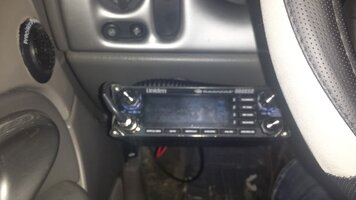

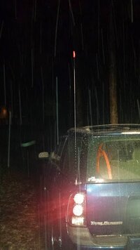

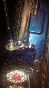

I installed my CB and antenna tonight.
The CB is a Uniden Bearcat 980 SSB. It is probably overkill for anything I need it for but like they say go big or go home. I am using a Jeep mount, Firestik fire ring antenna cable, and a 4' Firestik II.
I was playing with the built in SWR meter and was reading 8.5 and that gave me a bad feeling. After playing with it a bit I realized the antenna cable was a bit loose and would jump down to 1.5 if I moved it a bit. So I redid the antenna connection and it was reading a constant 1.0, I think its too good to be true so I will run it with an analog meter tomorrow. The weather comes in crystal clear, and I had picked up a few people while scanning. I need to go back and clean up some stuff and finalize some of the wiring as it was cold a snowing/raining while I was doing all of this.

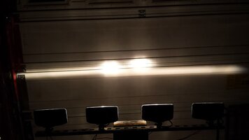

Im still working on that light bar as well. I ran all of the wiring and had it all nice and pretty and zip tied and of course, in my infinite wisdom ran the wires to come out on the passenger side. No big deal, just spin the lights. 3 went perfect the last one was to tight and ripped the wiring. So while it is broken down for paint I am going to redo the wiring on the harness for the last light and put it back together.
Here is a shot of all the lights working, keep in mind it is only 3' from the wall so the beam pattern is crap.
