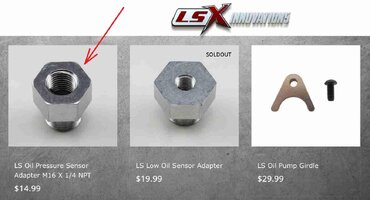

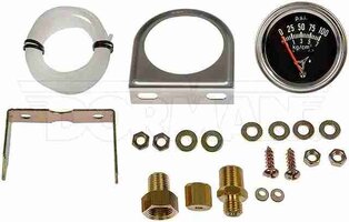

Barring this action... you can also install an Analog Oil Pressure Gauge via the External Oil Pressure Feed Port located on the Front, Driver's Side of the Block and Thread In an M16 X 1.5 Metric to 1/4" NPT (Nat'l Pipe Thread) Adapter and run a slender White Nylon or Copper Coil Line through the Firewall and into an Analog Oil Pressure Gauge via this Kit:
Several companies sell this M16 X 1.5 X 1/4" NPT Line Adapter:
