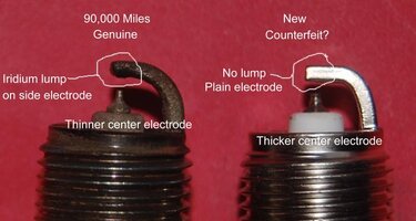

Just a little update, I recently replaced my plugs and I was the victim of the fakes that I installed years ago.
Just a note of these new genuine ACDelcos, they did not have a sleeve of any kind, nothing to protect the side electrode from being banged and changing the gap. I sure hope these are genuine as I paid full pop for them on RA.

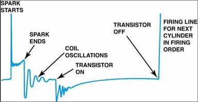

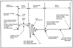

The more I think about it... it makes sense that any poorly manufactured Chinese KO Spark Plugs might directly tie in with Failing COPs if they have to work so much harder to create the Spark-2-Gap firing events and over-stress the Primary Coil side with excessive heat from the Secondary having to Jack Up the High Voltage (in KV) too often and result in ruining the COPs over time from the Primary getting pounded by those HIGH KV Oscillations:
Even having that "Ribbed Radiator" on the top will NOT be enough to diissapate the excessive HEAT that can build up on the Primary Coil Side. IIANM.. @c good might STILL have a few "Ribbed Tattoos" as artifacts left on his fingers (and a picture of it) from touching one that was -=SERIOUSLY=- Over-Heated!
