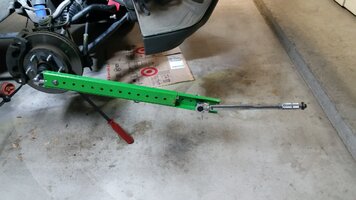

I did once a long long long time ago. The manual said that the crush sleeve needs to be repalced. Didn't have a torque wrench to install a new crush sleeve so I marked the pinion to the yoke to the nut and just turned the nut a little more to make up for the lost crush of the crush sleeve.
Basically did it the way this guy did but without the impact. I had to fabricate a bar with holes to use the strap bolts to hold it while I loosened and tightened the pinion nut. Don't remember using a puller.but this was about 35 years ago. An impact would help tremendously.

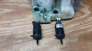

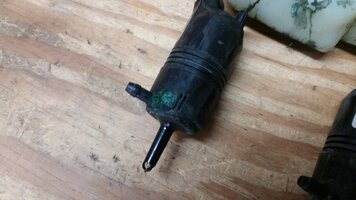

Finally got around to tracking down the source of the washer fluid leak. The rear pump (below, left) is leaking from the pump body; will add a new pump + seals to the RA shopping list. The temps were quite pleasant so I went ahead and rotated the tires as well. Only negative was finding a torn CV boot on the right side; will add that to the shopping list too.

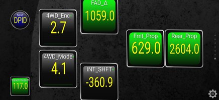

As usual I have been noodling about in the inner workings of modules such as the TCCM, trying to find ways to get at data the specific module doesn't give up easily.
I think I have developed a way for me to read such things in Torque Pro and Car Scanner albeit at a somewhat slow refresh rate of perhaps approaching 3 second intervals. If that is all I can get I'll take it.
What I am specifically looking at right now is what is the rotational difference of the two opposing gears inside the front axle disconnect at various vehicle speeds and such. I know the owners manual states one can switch to 4WD mode at any speed but I want to know more about what is happening inside the disconnect at the time of changeover.
Pretty sure I don't like the idea of meshing those two gears when the rotational difference between them is approaching 1100 RPM!!
Seen here in a Torque Pro screenshot where "FAD_∆" is Front Axle Disconnect delta.
"INT_SHFT" is the intermediate shaft rotating -360.9 RPM in the reverse direction.

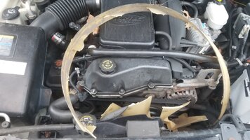

Took the TB out to shop and when stopped, could smell fuel. This pretty much confirmed my worst fear.
Fuel pump leaking probably from a rusted out line. Ordered the Bosch fuel pump and Spectra tank straps from RA (my 5% discount code was expiring on Jan.1) and the lock ring, bolts and line clips from Amazon. Close to $500 total and not including the garage rental I'll have to do.

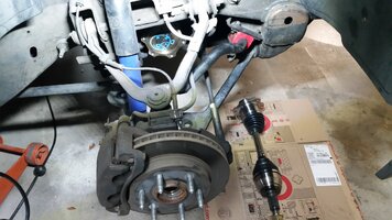

Went to replace a torn outer CV boot only to find that there was no access to the retaining clip that holds the shaft in place; looks like it is internal to the inner race. Bummer! Not a complete loss as the joint felt a little rough as I moved it around (also, the outer race is showing some discoloration due to heating?). Looks like a visit to RA is in order.
Well,......this was a few days ago, but I was able to pull a little here and there to straighten a few things out....

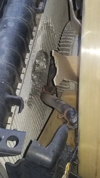

The receiver hitch behind the rear bomber cover of the other vehicle won this engagement. The Emvoy bumper went under the other bumper so the core support was pushed in pretty hard.
I believe it's repairable with minimal body work,.I will need the core support welded and I'm sure there's still alot of fine detail work that needs to be done.
I have access to a black donor Envoy front end so all parts are avail.
I'm fine with the fact it's 20 years old, 335K miles, if worst case comes around.. I have gotten a great life out of it.
However.... in the last year and a half, I've put about $1800 into it with a bunch of new parts given the age, more for preventative maintenance....and it was a turn-key, long road trip vehicle with no worries.
It will need a condenser, radiator, fan, fan shroud, header, lights, bumper cover and what's behind it.
No airbag deployment, just a folded in front end..
Surprisingly enough, I was able to start it and drive into an adjacent lot when I arrived...with some clicking of the harmonic balancer against what was left of a fan blade.
This was before I pulled on it, it was close to being really bad.
Lower core support mount, no frame damage thankfully.
Behind bumper cover.

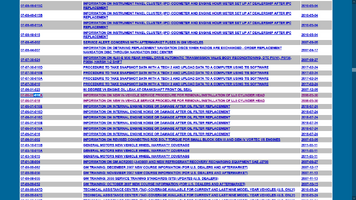

Also though, do we have a TSB cache hotlink up on the site? I know @Mooseman THE MOOSE MAN HIMSELF has graciously brought the isuzuzz ASCENDANCING for all of us to cherish on his signature, but I couldn't find a specific grouping of TSB in a forum folder in technical discussion form search, but hey, I could -just not be able to see the forest for the trees- because I've been *underwater* today trying to find 07-06-01-018(now updated to present day -018A) @gmcman you're kicking ass and taking names - @azswiss did you make that torque multiplier? Please forgive me if I'm not noting a badass brand attached to that reveal, but that's a slick form factor design and I haven't seen it before.
Pulled this out of GMSI. If you're familiar with downloading torrents and working with VMware virtual machines, you can get a copy here :coffee:
@SovietExplorer I found the ISO image, and created a torrent, I'll let this seed for a while, see if you can unzip and open this torrent file.
Thanks @808. Homemade, nothing fancy. Two pieces of shelf channel bolted together to secure a large breaker bar in place and a large nut on the other end to attach the torque wrench to. Based on the dimensions of the multiplier and the torque wrench the multiple is about 2.6x. (Edit: typo).
Thanks @808. Homemade, nothing fancy. Two pieces of shelf channel bolted together to secure a large breaker bar in place and a large nut on the other end to attach the torque wrench to. Based on the dimensions of the multiplier and the torque wrench the multiple is about 3.6x.
@azswiss *Bloody Rippah* Mate, BLOODY Rippah. Very lean industrialism. I dig that table ye got there as well!!!! Nigh invulnerable woodsies all buttoned and snipped right tight - those joints look wicked cozy ;)
