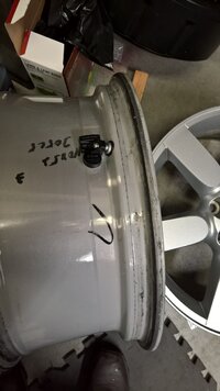

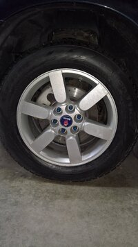

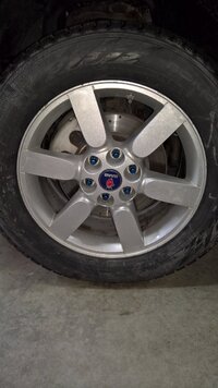

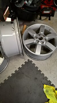

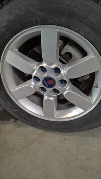

Three year ago I purchase a set of 4 Saab silver painted wheels, with tires that I could not break loose from the rims with my Harbor Freight tire changer. So last week I took them to a local Les Schwab tire dealer and had them remove and get rid of the tires. Yesterday I got the pressure washer out and super cleaned the wheels. Today I polished then ceramic coated (Turtle Wax) and installed new set of TPMS. My 17" Saabrolet wheels with 235/65r17 Nokian R2s are down to 4 32nds and the snow flake is gone so now I'm checking out some Nokian R3s 245/60r18s in a couple of days. The old ones are on for now because of the weather but they won't make it through a kind of real snow. Only 1 of the 4 Saab center caps is nice looking... I'll have to find some more....

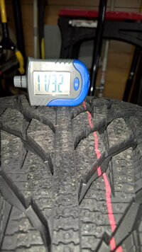

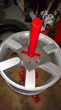

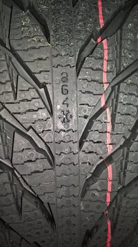

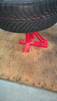

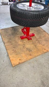

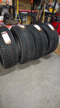

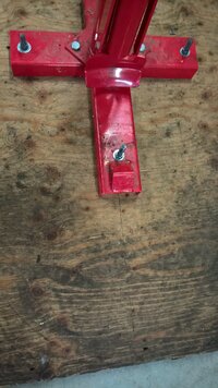

Got my new Nokian R3s from Amazon via Fedex. All 4 are now mounted and balanced (LOL) close for now... Sitting in the garage now with 45 psi until tomorrow late morning and I'll put them on the Saab.
Update new tires and wheels installed! Also cleaned up the shop so I can get both cars in again... winter is on it's way!

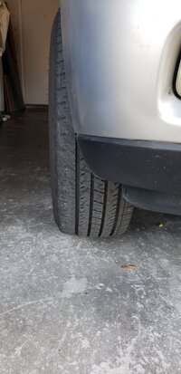

Finally got around to taking it to a tire shop, and getting the front end re-aligned. Meant to do it after replacing the LCAs due to the bushings on the strut yoke being wrecked, but other things got in the way. Noticed a bit of extra wear on the outer edges of the tire, and since I had the day off today, went 1st thing this morning to get it done.
When I do all my fluid maintenance this winter, I may rotate the tires and put the fronts in back. :undecided:
ETA: For the most part, the truck drove just fine, but in tight turns (close to locking the steering wheel), there was a wobble in the handling, and the tires would squeal slightly, that's gone now

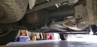

Well sh!t! My front diff has a good leak and seems to be coming mostly from the axle seal since I would fill it and it would leak out to the bottom of that seal and mostly stop. I had cleaned all of it with brake cleaner to see exactly where it was leaking from and it also seems that the filler plug seal seems to not be doing its job neither. I ordered both. The drain plug seal I'll replace with an aluminum or copper washer instead of that nylon one.
And today, was also greeted with the soothing sound of the hum of a wheel hub. Sounds like it's coming from the left also so I can kill two birds with one ratchet swipe. I'll likely rent a bay at the DIY garage since it's too cold now to do anything outside.IMG_20221114_131013_resized2529612962637220048.jpg

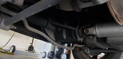

I guess misery loves company... I just went out and had a look under mine, and the rear diff is all wet, especially at the bottom of the cover, but no drops on the garage floor. I remember when I changed the fluid the last time, and ordered a Fel-Pro gasket, I got the wrong one and couldn't use it, so I reused the old one. I guess that borrowed time ran out... One more thing to the winter maintenance to-do list. :ugh:

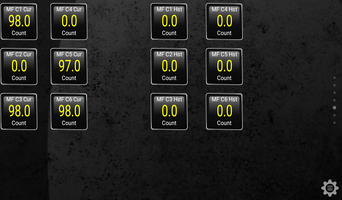

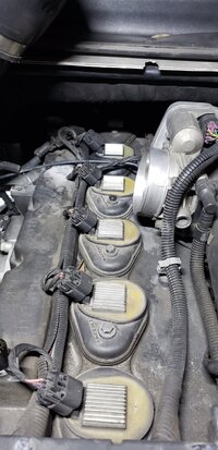

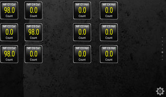

:worried: And the dark cloud over the EXT continues to follow me. Halfway through the morning stop and go commute, it felt a little sluggish as traffic pulled away from a light, and then the engine seemed to kick in. Strange, and then the CEL started a slow blink. As I slowed to idle, it began to run rough, so we all know what that means. :mad:

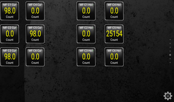

At the next light, opened Torque on the HU, pulled up a blank page and added all the misfire counters. Guess we know what I'll be doing when I get home this evening... I've got a couple of spare coils, hopefully that's all it is.
Or water in the well. Did it rain hard recently?
The EXT is finally a garage queen, so while we did have that tropical storm pass through last week, she stayed nice and dry the whole time. I want to say the old aftermarket coil I replaced somewhat recently was on #4 (it coulda been #5), but the OEM coil I put in place was new to me from a former member. No idea how old or used it may have been before I got it. Will have to swap a couple when I get home. :undecided:
The drive home was smooth, which was unexpected given how rough the idle was getting to work this morning. Kept an eye on Torque and the misfire counter popped on #1, but nothing else. Historically, Torque has always shown me misfires randomly even when everything was fine, so that's my grain of salt to take.
It wasn't until I was almost home, that I felt some hesitation with the gas, and when I pulled into the garage, the idle started to act up, but not enough to throw a code again. So that tells me it's going to wait until it's good and warmed up before the problem sets.
Popped the hood and indeed it was #5 that I had replaced previously, as that coil was visibly newer than the rest.
Looked in the spare parts box, had another Delphi coil, and a new aftermarket one. Swapped the other Delphi in place, marked the one I removed with a piece of red tape for identification. Let the truck idle halfway in the garage until it got warmed back up. Revved the engine a few times and watched the misfire counters. Nothing too helpful, it pinned some numbers on #1, #3, and #5 that didn't change, unlike this morning's drive, and the idle felt good. Each of these is about 1 minute apart.

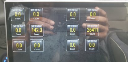

Tomorrow morning, have a Dr appointment that's post-rush hour, so won't get a good test in there, but will be heading into the office after lunch, so the drive home is what I'll really be paying attention to.

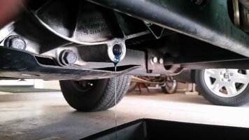

No staged pics, but swapped out 7 quarts of oil and a new filter this morning. While I was at it, went to address the rear diff leak, or so I thought :confused:
On closer inspection, not only was the bottom of the pumpkin oily, but the entire assembly, both axles, and the front of the diff was oily too. I wouldn't think gear oil would spread all over everything like that, if the seal was leaking, especially flowing forward. :undecided: Put the passenger side of the EXT up on a jack stand so I could roll underneath. With some cardboard under the diff, pulled the fill plug, which fluid promptly started coming out of, so I put the plug back. I checked my previous diff gasket order, and it was in 2017, so if it was leaking for a considerable amount of time, the fluid level shouldn't still be at the fill plug level (after sitting parked for 3 days) should it?
More recently, I swapped the transmission pan to one with a drain plug, and didn't tighten it enough, which resulted in a spray of tranny fluid all over the undercarriage. I sprayed degreaser all over everything followed by a rinse to clean things up, but I don't remember if I went all the way back to the diff or not. But leftover tranny fluid spray makes more sense than a sprawling diff fluid leak, unless anyone knows of something I may have missed?
The only other possibility would be a brake line, but I would think you would have other symptoms there.
Just do like I did and hose the whole diff with brake cleaner until it's dry and then watch for wetness to show up. Basically how I confirmed my front diff axle leak.
I'm still using the original rubber diff gasket. And if I encounter a diff with a regular gasket or RTV, I replace it with a rubber one. No more gasket or RTV scraping. I'll use RTV if I can't find a bubber gasket.
