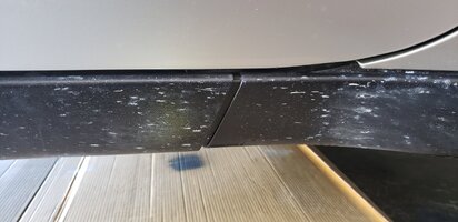

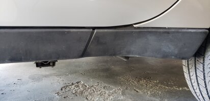

Since I had cleaned up the garage Friday night in prep for helping a friend work on their car, this morning decided to take a stab at the overspray on my trim panels. I didn't realize I already had a small bottle of latex paint remover, so I started with that on the rocker. Had to let it set for a minute, then used a scrub brush which seemed to work pretty well. After rinsing it off, there's a pretty decent amount of haze when you're up close. Still some bits of paint, but nowhere near as glaring as before.
I didn't do the back bumper or wheel wells (will probably skip those completely) and may go back over the rockers and door moldings again. That little voice in my head that suggested pulling everything and spraying them gloss black got a little louder too. :undecided:

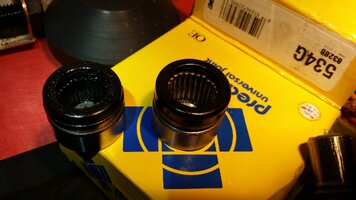

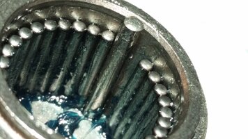

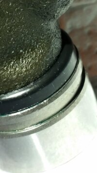

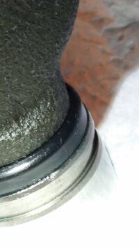

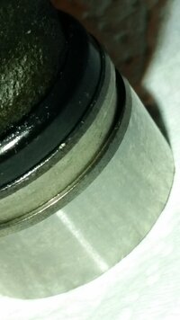

Just Dolled up an AC Delco 89029292 U-joint, greased the dickens outta the guts, finished a ding outta the trunnion endo, dry pressed the caps into the aluminum shaft yoke ears, and on the final wrench down for the last snap ring install *CRUNCH* crushed a needle bearing that had fallen between the journal bearing face and the cap. I *Do Not* reccomend following Spicer's guidelines to the "T" on this one. Give the thinnest&lightest&slightest grease skin to the cup O.D. mating surface for the press in. There was some carnage damage to the I.D. of the shaft ears. Just pressed it back out a few minutes ago, and by *The Grace* of God, I had ordered & have a count of #4 U-joints from the AMZN "GM Store" that everybody's been referencing. #2-89029292(now 1) & #2-89029290 Tomorrow's a brand new opportunity to investigate the situation anew. Hell of a day at sea.
Gentlemen may I submit to you "Made in Mexico" AC Delco P/N's noted in my previous post. There I was, bashing my skull in wondering why the centroid of the press fit kept wandering to side loaded digging eccentricity...... kinking in the bore.... well, yes it was dry, this is true. Here I present to you what I unfortunately overlooked as supposed OEM "quality". These examples of the "finished" chamfer/bevel shows exactly what I purchased, and exactly what I should have immediately deposited into file 13 upon delivery. This is the case: *all* end caps from this order were damaged. I could not find 1 without error, and all were sold as "new".

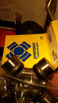

Thusly, O'reilly's. .AND HOW. Apparently, Spicer has had a *dramatic* decrease in Q.C. as well. Uncle Tony *was* right, just about everything on the market right now's closer to vulnerability than solvency these days. -Both- Spicers I opened up at the store truly were only *marginally* less damaged than those from the Mexican AC Delco assembly line. I gotta say though, this Precision is ***PRISTINE***, and their needle bearings have an O.D. that actually exceeds the AC Delco/Spicer, as both were absolutely typical in assemblage features, aside from what was a red grease in Spicer's guts vs blue AC Delco. Calipers told the truth of the cup O.D. at the counter, all is swell. Times have changed. -Breaks My Heart- to look at that beautiful turning on those AC Delcos and know that somehow, that Machinist's excellent strokes were mistreated after the operation. So close.

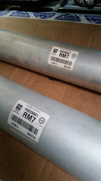

What @flyboy2610 said. ALSO, TODAY: From Pull-A-Part Atlanta. Another opportunity has presented itself to *FRESH* potential. '08 to '08. $ticker to $ticker. Different weights, but it's got 'em both and it's not distorted by a forklift tooth. Gonna go pick up ***GM*** Universal joints tomorrow from the stealership if *they check out* and then this fiasco is wrangled.
