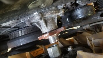

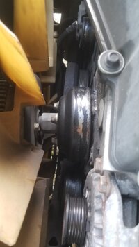

At 60 MPH, an hour and half from home...my water pump bearing failed....thought I threw a rod.
Was able to remove belt and limp to parking lot.....wife is bringing part.
Luckily I had most my tools with me to work on my buddies vehicle.... and a large crescent wrench with towing gear.

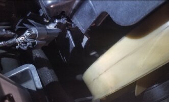

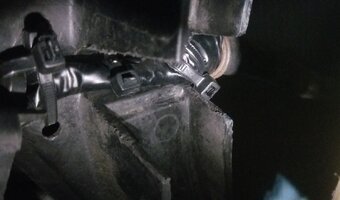

Just finished a broken wire fix on the fan clutch harness.
When the water pump went, there was no warning...the fan was forced sideways and it stopped dead. The very loud knocking was the harmonic balancer bolts tearing up the fan blade jammed into the balancer.
Must have really cranked the harness as it was torn from the plastic shroud.

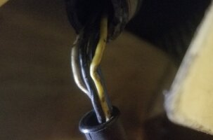

After I was back on the road, I had a CEL which was P0148.
95 deg ambient, pulling a trailer only about 1800 lbs gross, but in the hills at 60-70 MPH with the fan clutch on full tilt....was interesting.
Yellow wire was broken.
Had to remove the plastic angle which mounts to the fan shroud, removed a section of wire and re-spliced.
New repair.
Much better then buying a new fan clutch.
