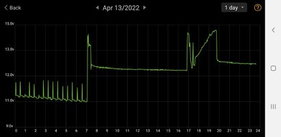

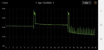

Earlier this week, the EXT cranked a little slow one morning, and the interior lights flickered badly while doing so. Turns out something had another cardiac episode just before the evening commute the day before, and pulled the battery down to 11 volts overnight. :wowfaint: Glad it started all the same. If I hadn't been parked in the garage, I probably wouldn't have noticed.
Screenshot_20220416-172450_Battery Monitor.jpgScreenshot_20220416-172459_Battery Monitor.jpg
Finally broke out my meter, and went with the fuse voltage drop method to check for a parasitic drain, hoping that whichever module that does this from time to time, would show some signs. Opened the rear driver's side door, pressed the latch so the truck would go back to sleep, and waited an hour. Took me about 15 minutes to go through both fuse blocks, and there was no voltage drop on any of the fuse contacts. For a quick test, turned on the headlights, rechecked the low beam fuse and got a reading of 1.6 mV, so I know it's not operator error or an issue with the fuse test leads (had never used these from my kit before)
So I guess I'll just have to get lucky, and catch the system having one of these fits, so I can run tests and checks while it's happening.
FWIW / FYI... my Sierra never exhibits those fits... it's just a sloooow, steady drain, vs. self-discharge rate disconnected.
I'm sure you've already thought of this, but if yours still has OnStar... I'd look there, as far as something 'waking up' / going into hysteria. They're known to take about 72hrs to finally 'go to sleep', after engine shutdown.
My Sierra still has it, and when I finally take something apart in the passenger dash area, it'll be coming out (mine has the floor console, so it's not something I'm looking forward to).
But since I don't have that spiking, my next likely suspect is the DDM, which is a known drain source on the 800-series trucks.
As for me... I worked on the battery disconnect yesterday (a fiasco; still ongoing), and kinda figured out my radio issue (the underhood fuse). Got the factory unit re-installed and working again, so I know it's not a factory wiring issue. So, 1-for-2... not a terrible day, considering.
I did, actually had the fuse pulled for OnStar for the past month, until Friday. So unfortunately that's not it. Was kinda suspecting the LGM maybe since it listens for the key fob, but not sure of a way to test that, other than swapping in a different one.

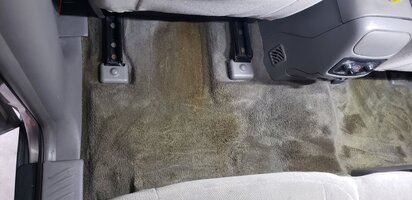

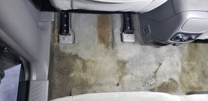

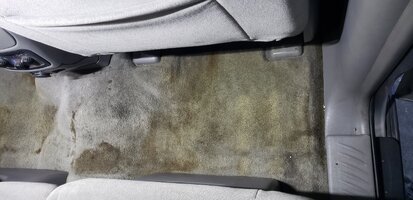

Unfortunately, due to my own neglect, the carpet for the 2nd row seats had gotten pretty bad over the years. The worst contributor, was me trying to test out the back seat drink holders, and got a large Sprite from a fast food spot. Thought it would be fine sitting back there, and out of the way. Well it wasn't, flipped right out, spilled all over the driver's side floor and the driveshaft hump. No idea what spilled on the passenger side, but as you can see, it wasn't a pretty sight, which the OEM floormats didn't do a good job of hiding.
Considering these stains have been there more than a decade, I was not expecting any miracles, but wanted to try and get things looking a little better. Had a can of foaming carpet cleaner from my apartment days, that was collecting dust in the back of a cabinet since I don't have carpet in the house, and went to town with it. Let that sit for about half an hour. Grabbed the large and small drill brush and my impact gun, and let those do their thing. I tell you what, I will never use a scrub brush by hand again!
Let things dry a bit, and then went over it with the vaccuum. By no means perfect, and there's still some discoloration, which was expected with the amount of FL summers those stains sat through, but it looks 100x better. Been half considering getting some Husky floor mats for the back, to match the ones I got up front, but I almost never have any people back there, so I've held off.

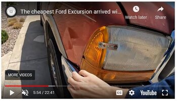

Interesting bit of repair in the video posted by @TollKeeper above. Has all the hallmarks of a true craftsman . . .
OMG... I need a rivet gun. The Sierra's headlamps have flimsy mounts and keep breaking. Got a JB Weld kit for plastics and will be using it today; haven't had luck repairing in the past. But I'm tired of buying new lamp assemblies
