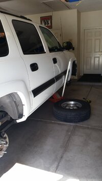

Last night after work, put the front passenger side up on a jack stand and pulled the wheel. Got my splash tub out and parked it under the LCA. Sprayed some Simple Green everywhere I saw old oil and let it sit for a bit. Rinsed that off, and things look a lot better under there. Poked around with a bright light, and determined the oil mess was from the CPAS :duh: Degreased that area and rinsed it down as well. I'll keep an eye on it, and see if that was a leak from before I replaced it a few years ago...
Today after work, got to work on the sensor. Tried to go in through the wheel well, but due to the length of my arms, I couldn't quite get the right grip to be comfortable, so ended up going from underneath anyway. Got the old sensor out, and the pigtail socket was full of oil, as was the plug itself. Sprayed out the plug with electronics cleaner, and let that dry while putting the new one in.
Got it hand tight, figured I might as well torque it to spec just because. Well the HF click stop wrench I used, didn't click, but it stopped permanently. Something didn't feel right when tightening the sensor, I felt like I was pushing too hard. As a test, I swapped the socket out for a 19mm and tried it on one of the lug nuts. Figured being set to 15 ft-lbs it should click right away, but it didn't. The drive head snapped off in my adapter instead. :mad: At least it's done now, a little peace of mind goes a long way.

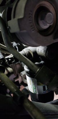

Weather eased up so I finally got around to the oil pressure switch. Wasnt to hard to get to, couldnt actually see it but with the right extensions it popped right out. Didnt like the quality of the ACDelco replacement at all... that same plastic looking metal as the elcheapos from the any auto parts store. Not easy getting it started in the hole but eventually got it in. Due to the angle of the sockets though I really couldnt get a good feel of how tight I was getting it. And not wanting to overtighten it due to the low quality of the metal means Ill have to keep an eye on it for leaking but it works just fine now.
Then I found a video on YT where you put the knock sensors in the cyl head and it saves all the work of having to remove the intake etc. Tried it and it was very simple. Took 10 mins. Have no idea if it will work or not. Deleted the codes and after 25 miles or so they havent come back....yet! If I remember right it went a lil farther than that when i reset them before so Ill know more in a few days if its going to actually work or not. Something else I was surprised to learn is that when the comp pops the knock sensor code it changes the timing advance settings to adjust for engine knocking. Delete the codes and the timing goes back to normal and it runs a lot better. A very noticeable change...once you know about it :bonk:

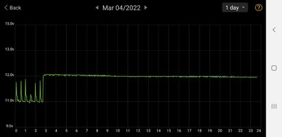

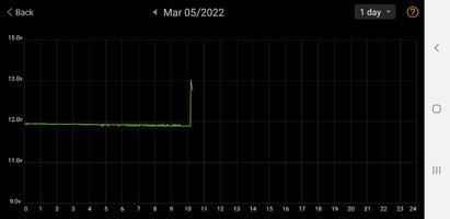

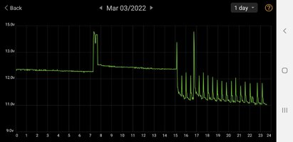

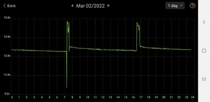

While in the garage this morning, it dawned on me to check the status of my battery. Since it gets low after 4 days of not being driven, I figured why not see where it was after 36 hours of downtime. Not entirely to my surprise, the app said the battery was drained. As I put the charger on it, I went to check the history of the last few days, and saw something quite interesting.
This is Wednesday, normal work day in the office. Pretty big voltage drop to start the morning commute, but other than that, looks normal
Thursday, I also went to the office. No crazy voltage drop in the morning, but around 3pm, something woke up and threw a damn party. :eek: The 3rd spike is from the evening commute, but as you can see, whatever was happening, continued until Friday morning around 3am before going to sleep for good.
Screenshot_20220305-100749_Battery Monitor.jpgScreenshot_20220305-100810_Battery Monitor.jpgScreenshot_20220305-102023_Battery Monitor.jpg
Charger is on it now, last time on the low setting, took an hour to fill back up. I'm suspecting either the OnStar module, or the radio. Pulled the OnStar fuse, and will monitor things more closely for the next week to see if this weirdness happens again. Not to mention see if the rate of drain on the battery changes.
I may disconnect the radio later. I can go without tunes for a couple of days. Seeing how the dashcam continued to record long after RAP tells things to turn off seems problematic. 👎 But yeah, whatever was happening for 12 hours is beyond strange.
