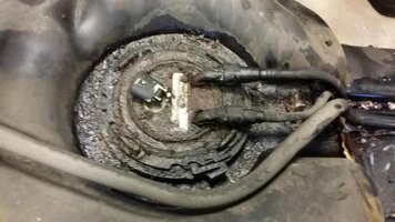

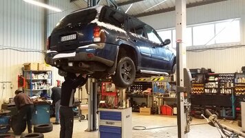

Pulling a fuel tank in the shop on a customers TB, leaking fuel from top of tank. Need to pull it to see where the leak is.
Let me know how that goes. Mine will puke fuel if I let the gas pump fill it until it cuts itself off via it's float valve in the nozzle (or however that works).
Metal pipes going through top of pump module rusted so bad it was leaking fuel when you run the pump.
Maybe your's leaking from the filler tube:
http://forums.trailvoy.com/showthread.php?t=101724
