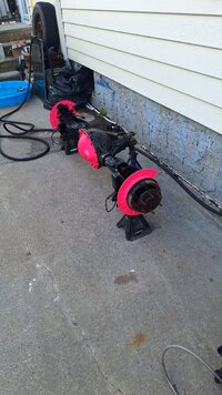

Not today but a few hours after work last week and yesterday. I've been prepping and finally got to Por15 the 14 bolt tb SS rear diff I had laying around.20240803_175039.jpg
The kit did not come with enough por15 to do 2 coats. Luckly its avaliable at autozone so i'll get another can and rough up the surface on the diff and reapply since its well after the 6 hours recomended between coats.
And yes I know the brake dust covers are beat to hell but I have a new set on hand along with diff cover, seals, bearings, u joint all ready to get put in.
Thats one of my big regrets with my Envoy... I have the 4.10 front dif, never found a rear, and I never got to enjoy it.. Now the Envoy is the spare vehicle, and no point.
Need to put that front dif up for sale...

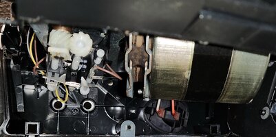

Got home from work yesterday, did a couple of things around the house before dinner. Went to close the garage door, heard a loud POP, followed by the hum of the motor, and zero door movement. Uh oh... :wowfaint:
This morning, opened up the casing to find this...
Took the casing completely off and could see where the shattered sprocket was supposed to be sitting. Looks like everything else on the spindle is still there, and the worm gear is still whole.
The whole spindle is under $20, so will just drop in a whole new one. But I'll need to address the original problem that caused this mess. My door is grossly out of balance. Back in 2021, I wanted to replace the old rusty springs, before they broke on me. A buddy was replacing his door with a storm rated one, and offered me his brand new spring, since he wanted to reuse his existing ones. I thought it odd to be just a single spring, for such a heavy door, but went with it and swapped it in.
Mistake... I could open the door by hand, but it was heavier than it should have been. Door opener didn't seem to strain at all, so I left it. Summer of 2022, the cable on my chain frayed and snapped. Plastic pulley above the door opening also broke. Replaced both of those, chalked it up to age. But now, can't ignore this anymore, time to get things right. Still had the old springs in the shed, so compared their measurements to what came out of an online spring size calculator, and they weren't even close. No matter which weight I input, these were way too long, and the cones weren't painted, so I don't know exactly what they were before all the rust.
Will get the door weighed this weekend, and order the correct springs to hopefully get here later in the week. In the meantime, will be parking on the driveway, and hoping mother nature doesn't decide to roll thunderstorms through here when it's time for me to arrive home from somewhere :hahano:

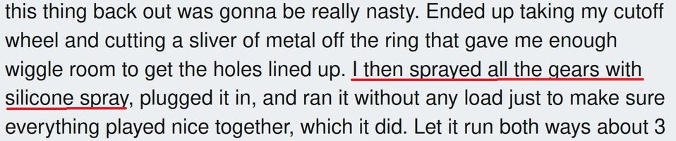

Today, decided to go ahead and get that spindle swapped out. Didn't go nearly as well as I planned it to. From YT videos, I knew the mounting holes were not threaded. So I took my impact, and drove the original screws through the holes to thread them for me.
Went to drop the spindle in place, and it wouldn't set into the lower bushing. OEM one slid out without much effort. First thought was it had a slightly different manufacturing spec, so use the one that came with it. Quick bench test, and the new one slid into the new bushing with a little bit of force. OK, let's take the old one out... It wouldn't budge. Tapped the underside with a hammer, no dice. :undecided: Grabbed my big C clamp, and an impact socket, and used that to press the bushing out, a la ball joint replacement.
The joke was on me though, because then the new bushing didn't want to go in easily either. Hit it with some silicone spray, used some different sockets and had to press the new bushing in. Pain in the ass. And then on top of that, the new spindle didn't want to slide in. Ended up having to rig up some pieces of angle aluminum to brace on the underside of the plate next to the motor, since you couldn't fit anything on all sides of where the bushing came down, and then press the new spindle into place.
One thing that I noticed, but didn't address, was the OEM spindle has a slight bend on the edge of the ring where it meets the back edge of the opener body, as there's a lip of metal that bends upwards. The aftermarket one doesn't have this, so when you drop it in place, all of the holes are offset ever so slightly. :mad:
Honestly that worried me, cuz if something wasn't right (like this), getting this thing back out was gonna be really nasty. Ended up taking my cutoff wheel and cutting a sliver of metal off the ring that gave me enough wiggle room to get the holes lined up. I then sprayed all the gears with silicone spray, plugged it in, and ran it without any load just to make sure everything played nice together, which it did. Let it run both ways about 3 full cycles, before putting the chain back on, glopping grease all over all the gears, and running it again with just the chain. Smooth travel, a soft hum, no signs of any misalignment.
At this point, 2 hours had gone by, and I was much more sweaty than I planned since I had to keep going back and forth to my tool chest for things to work around the issues. Word of advise for anyone else doing this for the first time, don't try to replace the parts while still mounted to the ceiling. It's annoying and awkward. Just take the thing down and put it on your bench, or on top of your garbage bin (like I did) so you can maneuver stuff around. I probably would have saved a lot of time if I took it down in the first place. :twocents:
Since I was mildly irritated and a sweaty mess, decided to go ahead and disassemble the torsion assembly on the door. The drums wanted to fight a little bit to slip loose, and the bar acted like it didn't want to slide out of the brackets, but eventually let go. So the old spring is out, and all the tools I'll need to get the new set in are ready to go. Hopefully get to pick up the new torsion springs tomorrow or the next day. 🤞

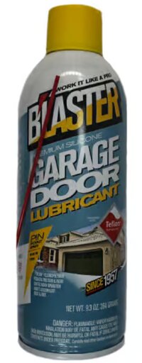

When I read this...
I thought, "He's probably using THIS Stuff..."

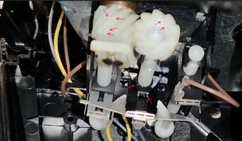

But after a closer look at your images, it occurred to me that with all of those *Exploding* Shattered Plastic Gear Particles Pin-Balling all around inside of that Metal Container... it might be worth taking a very close look at those Small Hypoid (Worm Pairs) of Gears governing the Micro-Switches for the Start and Stop Controls.
Because...if the Silicone Spray and other Lube being used did NOT manage to Flush them all OUT... Some of those Little Plastic "Wedgies" might actually cling better --in between the Gear Threads-- as shown in the Blow-Ups of your original Images Below and risk a different kind of FUBAR if the damned Bicycle Chain does not know when to STOP pulling the Garage Door Closed... Just my :twocents:
I appreciate the concern, and this is definitely maintenance I wouldn't want to do any more times than necessary. That's why I ran it multiple times w/o the chain just to make sure everything ran smoothly without any bumps, wiggles or unexpected noises, and then again multiple times just with the chain.
From my research, the spring loaded door should only weigh under 5 pounds when closed, so I have a mark to aim for and a way to measure it beyond "feel" Considering what I've been putting that garage door opener though for the past few years, I'm surprised it didn't grenade itself sooner.
