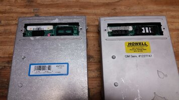

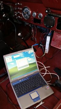

Diagnosing an intermittent electrical problem on the CJ7.
I replaced the original computer controlled carburetor with a Howell EFI kit based on a GMT400 ECM & TBI setup back in 2019 and had no problems until about 6 months ago.
While driving the fuel pump quits and the CEL goes out. It will usually recover after 5 minutes or so without any intervention on my part.
At first I though it might be a power distribution or ground problem but after inspecting the harness for breaks, bad connectors and poor grounds everything checks out OK.
Hooked up an old XP laptop running WinALDL and was able to connect to the ECM; verified no codes and all sensor data looked good. Wiggled all the wires with the engine running and no problems.
I am now left with the ECM as the only culprit (both the fuel pump relay and the CEL are controlled by the ECM through to ground). This is supported by the fact that several times recently at Key-On the CEL would not light but the engine started anyway.
My suspicion is that the previous voltage spiking issues (replacing the alternator & ignition switch fixed that problem) may have damaged the ECM .
Replacement is straightforward. Order the basic unit from AZ (reman, of course), then I just need to swap in the PROM & calpak from the old unit into the new one.
