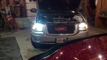

Installation of the highs and lows was a breeze, the only problem I had was that all the dang wires for the power to the ballasts were backwards. :crazy: I just flipped the plug over and it plugged in that way, it plugs in tight enough that there shouldn't be issues with the little latch thingy not catching anything. I decided to keep the rubber caps on the back of the lights, I just cut an x in the back of them and pushed the wires for the driver through.
I got a couple of pictures, but they do NOTHING to actually show how awesome these lights are. They aren't a bit blue at all, they're extremely white and amazingly bright. I've only taken one short test drive, but the brightness is amazing and the light output is definitely much greater than before. The only thing I can see is that before the halogens projected straight down the road a LITTLE further than these do, but the difference is negligible. That's a housing issue anyhow, not the bulbs.
Again, the difference in the halogens and these lights is actually much greater, phone pictures really don't do any type of lighting real justice.
The new pattern (low beam only). I wish I'd gotten a pic of the old one, but I was too excited to get the Crees in. The old pattern was smaller though, and dimmer. And yellower. :biggrin:
EDIT: Another pic, looks funny looking at the lights and not seeing a bulb. I like it!

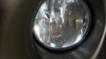

The difference is really amazing, I can't believe how much better the light output and pattern is. I had to dremel the area just above the fog light bulb holes on each side so that the heat sink would fit without binding, but all in all not much plastic had to go. I also noticed that the Cree 880 bulbs don't come with the rubber washers at the base, so I pulled the ones off my old bulbs and stuck them on the new LED bulbs and they fit like a glove. 880 Cree bulbs are also not "clockable" like the highs and lows, but the position the tabs are machined at is perfect for alignment in the housing anyhow with the LEDs firing at 9 and 3. I took the time while I was at it today to swap all the pins in the connectors of the drivers so the connectors will snap together properly as well, since thanks to GM the wiring is backwards. :crazy: As for driver mounting, on the headlights I was able to have the drivers lying behind since there's some room, but for the fogs I found a nice spot to ziptie them on the metal of the bumper bracing.
A big plus of LED headlights, aside from the amazing light output and lack of heat produced and the longevity, is the fact that even when they're off they look really cool. :cool: Makes a good conversation when other car guys ask me what the heck that is inside my headlights. :yes: I've only had the Crees a short time, and it's already happened. :wootwoot:
A side note to add: I've yet to figure out the radio interference problem but I am working on it, the fogs cause it by themselves now too. My next idea is to run another ground on the radio antenna, maybe down to the frame or somewhere, and see if that helps at all. First I'm gonna take a small portable radio, probably tomorrow, and set it on the hood and tune in to a station, then turn on the headlights and see if I get static. That'll tell me if it's a wiring problem or if the lights/drivers are actually giving interference, in which case I'm probably just SOL on getting the radio to work when the lights are on.
