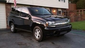

Took advantage of the low humidity today (finally) and gave the girl a well deserved deep cleaning, with a touch of polish. :thumbsup:

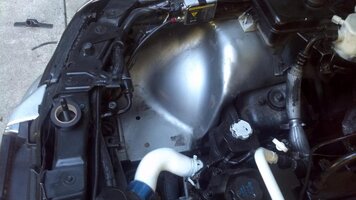

Well I removed the washer fluid reservoir from the engine bay to make room for turbo in the spring (this is not something I want to do when I can't feel my hands because its going to be too cold then)
I cut the wiring to the pump and added "extension" wiring to connect it on the inside and wired it back up.
I am using a smaller interior mounted reservoir up under the glove box from summit racing.
washer reservoir free.

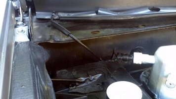

hose location

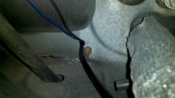

wiring and hose goes behind coolant reservoir and through fire wall
pump all ready for the reservoir. tested and works! (will be tucked up higher and further back)
