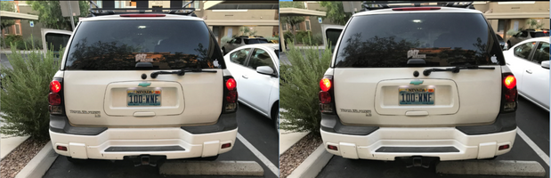

replaced both upper and lower control arms and the driver's side axle. Also replaced the brake lights with LEDs
Before and After shots
