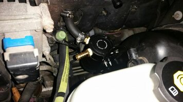

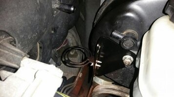

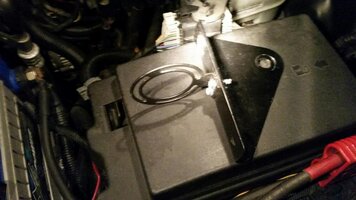

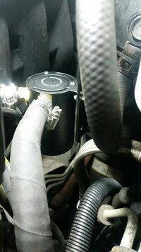

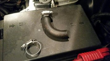

Installed a Mishimoto compact baffled oil catch can. Hunted around awhile trying to find a spot that I could empty the can from and keep the install somewhat neat. I've had some metal pieces laying around for a couple years and this one bracket worked out perfectly. Had to pre-drill the self tapping screws first due to the thick metal but the other large hole fit the brake booster bolt perfectly.
Trimmed the molded hose about 2 1/4" and this worked out just right since the inlet side was 90 deg to the return port on the intake.
I had a 1/2" ID oil resistant hose from McMaster Carr I picked up last year for this project and luckily this can uses 3/8" pipe fittings which accompany 1/2" hose barbs, cut hose to 17" to give me an easy radius to not restrict flow. I used this on the crankcase side due to the oil that will be laying in the hose.
Turned out better than I had planned, I may add another hose barb in the drain port if it fills up quickly to ease draining, but there's ample room to reach down and unscrew the can.
