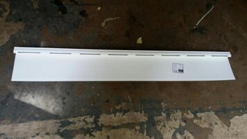

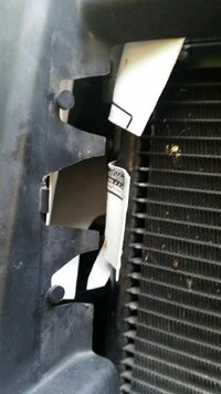

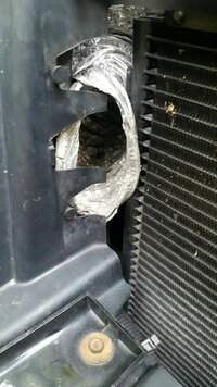

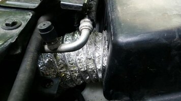

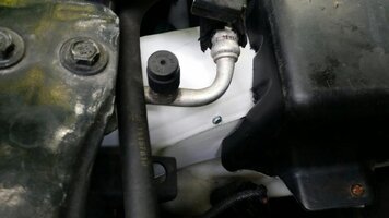

Messed around with my DIY makeshift cold air intake. I had a dryer tube before but took a piece of gutter cover (about $3) and fabricated a rough channel for the outside air. I also took my spare air filter cover and opened up the area above the filter to get more of the air to the rest of the filter. Seems every time I change my filter it's dark in one area which is near the front.
I removed the plastic deflector on the side of the condenser and core support to allow the air into the engine compartment. Needs some more fabrication but this is just a rough model. May not make a huge difference but it's cheap and it's pretty much a straight path into the airbox.

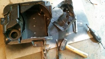

Opening the inside of the airbox was a show. That thing is ridiculously strong.

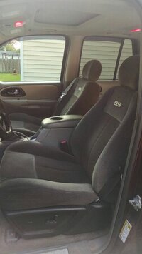

i actually like the black seats in the interior. had to change plugs and run power from the back seat, but works great. now my car and truck match

i really only care about the power option on the drivers seat, i don't care what color they are. I'd prob be up for a swap if you want the ss seats
