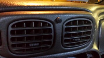

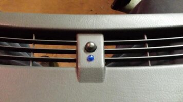

Also mounted the alarm warning light up higher in the dash.

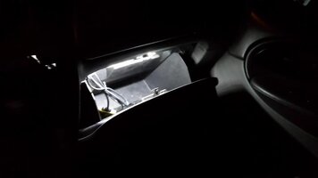

I test fired my LED glove box mod - WOW! For power I'm just going to do switched 12v instead of RAP (which was originally planned).
What originally started as project de-orange escalated into an unplanned mini makeover. :crazy:

That reminds me, that I need to do that mod as well

Yeah another thing we didn't get that the 02s got. :mad:
My 03 had the cutout for the factory switch but no wiring.
I don't know why GM thought we didn't need a light in the glove compartment...

:undecided: Hmm, I might do this mod just for kicks. Got some spare tilt switches, so just need a power source and maybe use a mosfet instead of a relay this time around.

I went the low tech route. Remember when I asked you about those 194 "blanks"? I put one of those blanks in the OEM light switch (where the 194 would go) and that is wired to the LED strip.

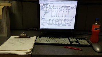

Today I'm coming up with a plan for the puddle lights that are part of the txblazer inserts. I want them to come on only when the truck is off and the doors are unlocked. I think I can get away with wiring a relay at the bcm and running a lead up to each door.

I really should make a thread about this but first I need a little more time with the diagrams just in case I'm being unrealistic with what I want. :undecided:

I'll be drawing schematics at thanksgiving dinner. :woot:
