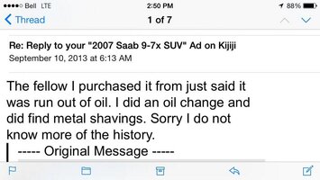

I found out the owner of the saab bought it with the knock and found metal shavings in the oil when he did an oil change. This leads me to believe that it had the burning oil issue caused by the AFM, because its at 200,000 kms for a 2007 so i know its mostly if not all highway kms (when AFM activates)
Hopefully he didnt use it as a DD still and completely score up the insides. I'm thinking it might be better to do a complete engine swap at this point.
What engine options do i have considering its has the 58x reluctor wheel? I know i can always get the lingenfelter 58x to 24x converter

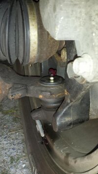

Daddyx2 here is the pic you requested. The zerk fitting is in the center of the pic with a glob of grease on it.

rock on man, thanks! now for the follow up questions. having never owned a grease gun in my life, are they 'one size fits all', or are there specific sizes needed? and access to these points is pretty easy without having a lift or jack stands?

All zerk fittings are a standard size. Some of my components came with straight ones others 90 degree ones. I faced the 90 degree ones towards the back. You would need to look to see what direction your mechanic put them in. As for greasing, I did mine in the parking lot at Auto zone. For the difficult to reach ones I turned the steering to full lock one direction, greased, and turned the wheel to the other side and did the same.
Now you will have a few choices in grease guns, I recommend one with a flexible hose as it makes things a lot easier. Also you will have 3 oz, and 14/15 oz. Pay the extra for the big one as you get more for your money. You could also get a grease gun and bulk tub of grease. This would require packing the gun instead of swapping tubes, can get messy.
Like I said $25 will get you a tube of Mobil 1 and a grease gun with a flexible hose.
blazinlow89 said:
All zerk fittings are a standard size. My some of my components came with straight ones others 90 degree ones. I faced the 90 degree ones towards the back. You would need to look to see what direction your mechanic put them in. As for greasing, I did mine in then parking lot at Auto zone. For the difficult to reach ones I turned the steering to full lock one direction, greased, and turned the wheel to the other side and did the same.
Now you will have a few choices in grease guns, I recommend one with a flexible hose as it makes things a lot easier. Also you will have 3 oz, and 14/15 oz. Pay the extra for the big one as you get more form your money. You could also get a grease gun and bulk tub of grease. This would require packing the gun instead of swapping tubes, can get messy.
thanks a lot man.
