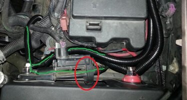

Finally got around to completing the "Big 3", sadly I think my lights dim more now than before :undecided: I guess it is time to upgrade to a capacitor.
i notice you are bypassing the current sensor on the ground. because of this, the ecm can't "detect" the load on the battery and is probably not kicking on the alt to full power. you should consider fixing this.
I was not sure which route to take. I have read that it makes no difference to bypass current sensor, but what you are saying makes sense. I will have to look into what I need to do to incorporate the new ground to the sensor. Thanks for the heads up.
cram as much wire as you can in the sensor and screw it to the bolt on your fender in the far right of that pic. Then tie all your grounds to that point instead of the battery.
I appreciate the heads up. I will have to check out my wiring tomorrow. Hopefully that will save me from needing a capacitor.
