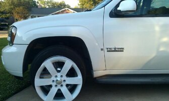

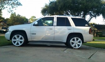

Change over to winter rims. steps & grill
