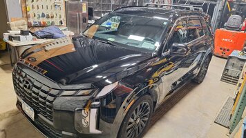

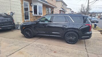

Not today but 3 days ago my wife got a new daily driver.20251226_093558.jpg20251226_093544.jpg20251226_093534.jpg
It's a 2025 Hyundai Palisade calligraphy night edition. Wow, The amount of tech in this thing is crazy.
The Voy will remain in the driveway till we figure out what to do with it in the spring. We would rather part it out then hand it over to a dealer. She still runs great and has a fair amount of new parts, but rusting out pretty bad on the passenger side frame rail. I guess 18yrs and 280k miles will do that.

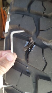

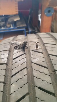

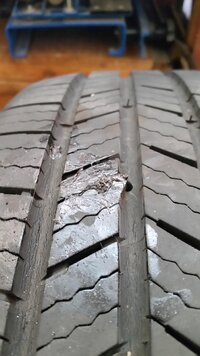

Fixed a flat tire on my wife's XC70. Nice little roofing nail! All good now.
I once heard air pissing out of a tire on my Yukon as I exited the vehicle. Brought the tire/wheel to a local western auto. They called me later to say they could find no leak. I went and got it and told them I would be back after marking the leak. They even immersed the tire/wheel in a tank and found nothing.
I soaped it up good and like them I found nothing,,,,, until I released the pressure way down to single digits. Then I could flex the tread and there it was. A small slice that was closed by pressure unless the weight of the vehicle stressed that area.
It could not be repaired well enough to be anything but spare duty but I wouldn't even trust it for that. You never know how far from civilization you will need the spare.
