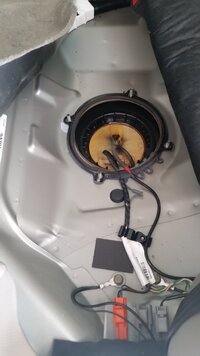

Went to replace the leaky seal around the fuel level sensor on the XC70 and made two unfortunate discoveries. First, & foremost, the lock ring was not tight!! This is the first time it has been checked in 18 years so it was either loose from the factory or the o-ring seal has shrunk. Second, the opening for the level sensor is below the top level of the tank. Consequently, since the tank is almost full (naturally) as soon as I start to loosen the lock ring gas starts coming out. Decided to tighten up the lock ring and drive off some of the gas in order to bring the level down below the fuel sensor opening. Fortunately, access is very straightforward from the floor of the rear seat so I did not have to drop the tank or remove excess interior stuff.

The fuel level on my wife's Volvo XC70 was finally low enough so I replaced the o-ring seal on the fuel tank level sensor. Sure enough, the old one had flattened out enough to allow fuel to seep past. The new one went in easily. Will wait to run through a full drive cycle to make sure the evap leak is fixed before I declare final victory (P0442 evap leak DTC flagged & CEL lit).

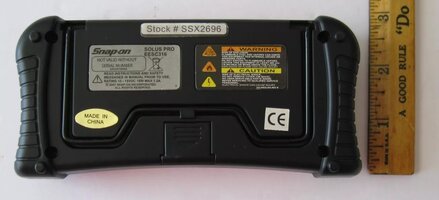

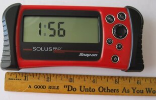

Poking around on eBay just now and thought these two items would make it a *SNAP* To Keep Good Time... These two Digital Clocks are both clever, and *cute* in a sort of way that feeds into the frenzy of learning and appreciation I have been developing of late after falling in love with affordable, low priced used Snap-On Diagnostics Equipment. So I grabbed both of THESE as they are very unusual and useful collectibles and... because I will enjoy having them around... (Along with a REAL Snap-On Solus Pro arriving in just a few days... :>)

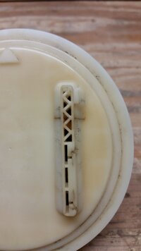

Had to deal with a comeback to Squirrel's Garage!
There was a lingering smell of gas in the garage after last month's replacement of the fuel level sensor o-ring seal on the XC70 so I decided to check for any sign of leaks. To my consternation, I found a film of gas on the surface of the sensor. After drying the surface I noticed gas seeping from a hairline crack.
Checked the picture I took last month and sure enough, there was the crack. I had missed this hairline crack because I was focused on the much larger leak coming from the failed seal.
Replaced the level sensor and installed a new o-ring (even though the "old" one had only been installed for a month; no sense being penny wise & pound foolish when it comes to potential fuel leaks!).
