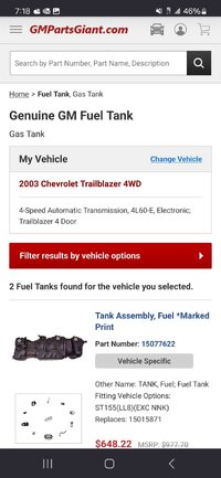

That tank p/n does not show on gm parts list. If tank fits in frame and fuel pump sender assembly fits snug into recess cavity with float clearance you may be able to make it work if not completely accurate. Here are screenshots of 2002-2003 trailblazer fuel tank p/n 15077622 with slot for external fuel filter.

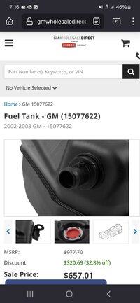

Found some info on the fuel tank p/n 15229311. It is very similar to 2002-2003 trailblazer fuel tank p/n 15077622 but has more capacity on the front end of the tank. You may have the 22 gal version of the fuel tank so it will work with the new fuel pump assembly.

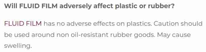

I know I asked this before but I know the top of these fuel pumps rust fairly quick. Ok to shoot it with fluid film after it's assembled and right before it's put back up in place? Asking because says it has penetration properties. That wouldn't loosen the lines would it? And obviously would cover the wire connector before I coat it.
I wouldn't worry about using FF. It wouldn't penetrate past the rubber seals.
