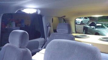

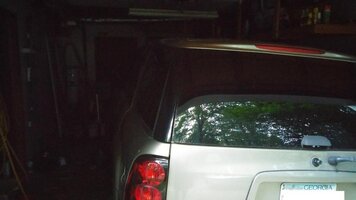

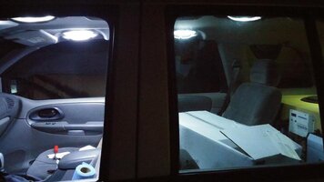

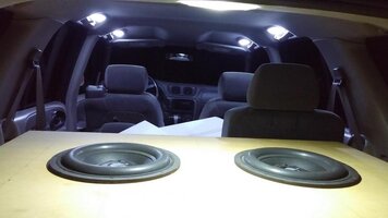

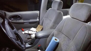

I just wanted to share my new interior lighting, I didn't really go into this thread much and really don't know much about the different version of LEDs on the boards I bought the Cutequeen T10 2835 20 SMD 194 bulbs in "white" http://www.amazon.com/Cutequeen-Trading-Lights-20-smd-Lumens/dp/B00H1ES6S6/ref=pd_bia_nav_t_2?ie=UTF8&refRID=0C1HHZS182YNDXT909T5 and the CuteQueen 42mm festoons white 16 SMD http://www.amazon.com/Cutequeen-White-16-SMD-Festoon-Light/dp/B00B2YE4B4/ref=pd_bia_nav_t_3?ie=UTF8&refRID=0C1HHZS182YNDXT909T5 I plan to use the extra 42mm to add footwell lighting upfront.
In the meantime here are some pics of the output, one pic is from outside the garage so you can see how dark the garage is for reference, pics 2 and 3 have the rear hatch open, the 4th showing the front seats has the hatch closed and the side view of the 2 doors has the front window down and the factory privacy glass on the back side door up.
edit: pics are in reverse order from how I listed them. we'll see how they last. Pics taken at 8:40 PM

Holy moly - do you have a suggested SPF for your passengers?
Yeah, they light up pretty bright. I swapped out to the blue. Last night I clicked on one of the map lights. I thought it was full brightness as I had the visor mirror open a minute before. It was bright. My passenger opened the mirror and it went to full bright - I thought it was going to burn my retinas.
funny you mention the map light, that is the one odd thing about these bulbs (maybe all LED's in that location on these trucks, I don't know as I've never tried other LED's) but if I push the light to turn on the map light (front bulb) it's like really really dim basically useless like it's not getting full voltage or something but everything else works perfectly the "theater dimming" of the lights after closing the door and they go out COMPLETELY there is no subtle glow like some car forums report from LED interior lighting.
I always felt like even with the stock 194 bulbs this was one of the most well lit vehicles I've ever been in and was afraid after my experiences with the LED bulbs walmart now sells in the automotive section on my firebird that I would lose light from going LED like I did on it so I went with the medium size (T10 instead of standard T5) because I wanted to get the biggest amount of LED's per bulb I could fit and was afraid the T15's would be to tall or else I would have gotten them.
