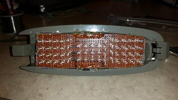

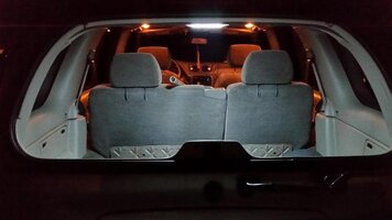

Been doing a little modding on a Silverado. Red 5630 dome light, red 5 chip 5050 map lights, and what we got done tonight, red 5050 door lights.
Were gonna put some of my red 5630 strip under the dash for footwell lighting but where we were gonna put the toggle switch didn't pan out after I got it all apart and it got dark before we figured out another place to put it so we're gonna try that tomorrow if I've got time.

Got 'er done this evening.. Stupid bright lol.
I like the brightness of my red LEDs in my domes, but as one friend put it (and I sort of agree) she feels like she's in a KFC chicken warmer. I've got the 24 SMD 5630 boards in each light. Funny, I stopped at 7-Eleven last night and when they came on as I got out of the truck, 3 kids looked and took off at a fast pace. Another reason I want to change it out - looks a bit like LE and I don't want it to.

Lol all I've noticed that I hate so far about red is that you can't see to do shit in it. Trying to peel the backing off of double sided tape sucked lol.
It also has a 24smd 5630 panel in the dome light like what you're running.
And for the Silverado's (what is pictured) and Tahoe's the front reflectors already have a light in them unlike TB's. You just have to enlarge the hole to make the LEDs fit through but other than that it's a 5 minute mod. Literally took less than 5 minutes to pop them out, hit them with a step drill bit, put the LED in and pop the housing back in the doors. Also done it on the Tahoe I was working on last week but I didn't have my drill bits and we had to carve the hole out with a box knife...took much longer but had the same effect.

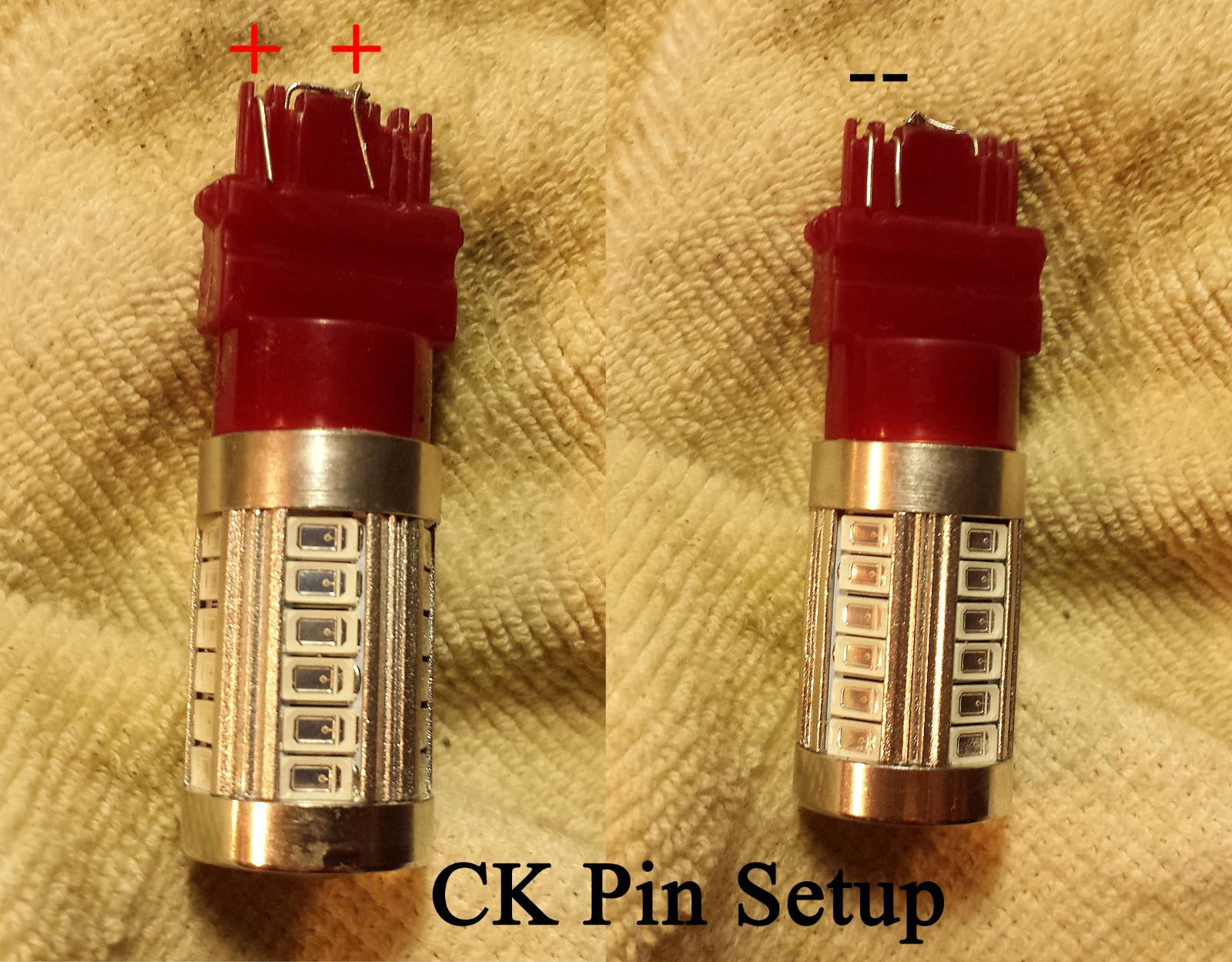

A few weeks ago I upgraded all of my red taillights to Aaron brand bulbs. I thought I'd share because they're bright AND cheap.
I have ordered 4 sets so far from the below seller and have been very impressed.
Red: http://www.amazon.com/Aaron-Power-33SMD-Signal-Lights/dp/B00ML7G5X6/ref=cm_rdp_product
White: http://www.amazon.com/gp/product/B00ML7DIJA/ref=oh_aui_detailpage_o02_s00?ie=UTF8&psc=1
At $19.99 a set you cannot beat these things.
Running lights are on and the 4-ways are on showing the difference between "dim" and "bright":
Light output is impressive:
I couldn't pop the base off of these to switch the pins inside for use in the CK sockets, so I had to get "creative".
To my surprise this mod works and the extension I soldered on is perfectly sturdy:

Those are indeed bright. I have orange ones for my front turn signals in the Mustang. They're from a different seller but they're all the same no matter which seller you get them from due to them being mass produced in China and wholesale'd for ~$10 a pair (depending on color) online to USA sellers. (Aliexpress is where I found them that cheap)
For future reference, to get the base off:
Straighten the pins out so that they're not holding any pressure on the base, then grab the bulb firmly in one hand, the base firmly in the other, then give it a firm, controlled twist. You want it to come loose but not spin around too much to risk damaging the wires.
(source: myself, one burned out and I took it apart to see the internals)

They must be using a ton more glue now. I have successfully pulled other brands apart and made CK's, but I couldn't get these suckers apart.
I had the base in my vice, a heat gun on, and I was yanking on the bulb with a towel so I didn't damage it and all I managed to do was partially break the top off. The base wouldn't hardly budge.
