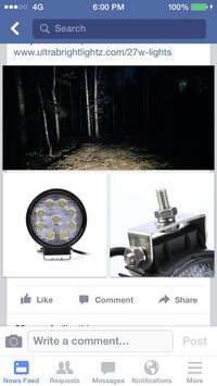

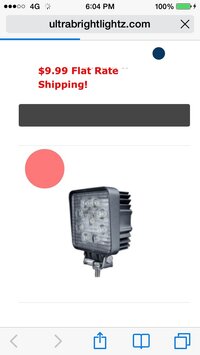

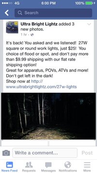

I looked at the ones I was thinking of. 9 x 3 watt bulbs in a square or round enclosure. They have the sale on again.
ImageUploadedByTapatalk1433466392.560876.jpgImageUploadedByTapatalk1433466419.711776.jpgImageUploadedByTapatalk1433466452.025074.jpg

He got the Ultra Bright Lightz brand? I'm wanting to try them, and have some credit from a really old return.
No. The amazon ones I bought. He bought same set for his jeep.
I'd suggest the eBay/Amazon brand. UBL appears to be a discount emergency lighting store. You can get the exact same ones on eBay for way cheaper:
http://pages.ebay.com/link/?nav=item.view&alt=web&id=201363342623

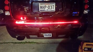

I'm really surprised none of you is hitting me up on any of this latest discussion. 5630 chips are now brighter than 5050 chips. Most strips are sold by the reel which is 5 M or 16.4 feet. 5050 is not necessarily brighter than others if you look at how many chips per reel. 3528 comes in 300 or 600 chips and let me talle you 600 is bright as hell! You can cut these strips into as little as a 3 chip segment (it has cut marks on them) and then you simply solder wire leads back on after scraping off the silicone at the end.
For the Cargo in back on our SUVs I have the 70 chip plate which is insanely bright and its plug n play for $10.
I'm now going to be doing red side firing 335 chips under the back edge of my bumper plates which can be used as running lights or 4th brake light.
Just get 5050 LED strips in the color of your choice, stick them to the ceiling. Should be stupid bright lol.
Some of the adhesive tape on these strips are affected by heat and will fall down if its not a smooth glass like surface. Just an FYI...

More pics, unlit, with placement, etc. would be appreciated.
5630 are brighter, and usually the 5730 are brighter than the 5630 but are currently a lot pricier. There are a lot of sellers with IP67 or IP68 strips for cheap, too.
We've known about 5630's being bright Kev. :wink:
I once had an idea about making a fourth brake light out of some surplus 5630 strip I had and some pwm dimmers and even making it work with turn signals like the ones you can buy pre-made but never went through with it because I didn't think it would look right on an SUV under the liftgate like under the tailgate on a truck.
