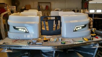

I did an LED mod to my garage. Put new light fixtures on the outside as there was nothing at all, then I used these Philips bulbs.
And this is the final result
