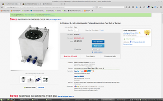

About seven years ago… I decided to design and build a completely Off The Vehicle Electronic Fuel Injection Cleaning Machine that could be assembled by anyone with access to the Internet and a Salvage Yard and an occasional trip to Autozone for the Cleaning Liquids to be used. Its ironic that well featured here is the Fuel Rail and EFIs that came off of a 2000+ GM Atlas I6 Engine that also features an intimate breakdown of what our EFIs look like from Top to Bottom… Inside and Out. This is the link to all the Videos and Images I used to document four generations of these experimentations that you might find useful:
http://s557.photobucket.com/user/60dgrzbelow0/library/HOMEMADEEFICLEANER?sort=3&page=1
The reason I mention all this now... is because way back then, I had to seriously consider using some chemicals that would not only effectively clean out all of the Mung, Dirt, Detritus and Debris that pumping 10,000 gallons of Sh*tty Gasoline through tiny micron-sized screens can build up over the life of any engine… and also possibly ATTACK AND DISSOLVE THEIR SEALS and then leak out all over my ostensibly clever machinery and ruin everything. What I discovered was that in general… GM and others in the automotive industry had faired quite well on a steady diet of all manner of seals made out of either Dupont Teflon (PTFE) in either “The Brown” flavor… or Viton in the “The Blue” flavor.
But even as comprehensive and careful as I was about doing all of this with chemicals like “Lucas Oil” and “Chevron Techron” Gasoline Treatment in mixtures that many Chemists would have suggested, “Okay Bobby… Put DOWN the Bottles...and Back Away VERY SLOOOWLY...” I never actually tried to use GM Top Engine Cleaner (AKA “Canadian KLEENZ” in the GWN). And so… Since “Past is Prologue” in this story… before I subject the “Swap-n-Drop” Replacement Engine to a sustained bathing in various positions and under some unique conditions with lots and lots of this stuff… I want to make damned certain that the PTFE Valve Guide Seals and the PTFE Engine Seals located on both ends of the Crankshaft will not dissolve before my very eyes. And so… #1 on the Test Runway… will be the Old 2002 GM Atlas Free Standing Engine Head ...and if those experiments work out and do NOT ruin the seals… then we'll try it out on the “Swap-n-Drop” Motor. Here are some images I copped of these Viton Blue or Dupont Brown “Poly-Tetra-Flouro-Ethelyne” Seals from my Photobucket:

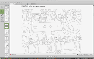

The next thing to be done on the Donor Motor is to rotate the motor from its present position of being turned nearly upside down to help drain out all of the "De-Carbonizer Black Pudding" that has dissolved and pooled from inside of the Six Exhaust Ports and then pull the Oil Galley Access Plug adjacent the Oil Filter and figure out how to set up the "External Electric Oil Priming" Hard & Soft-Ware in order to pump some oil throughout the engine first... before pulling the Spark-Plugs and attempting to turn the Rotating Assembly with Bone Dry Bearings. I will wind up having to do this task sooner or later anyway... so sooner makes more sense before turning all those dried out engine components. Besides... I want to see which of the several approaches to "Oil Priming" I can try are worth doing while the engine can "stand" it... easier done in the garage than in the TB. I'm just not taking any chances with this engine. Period.
EDIT:
Not so much of an "Edit" here ...as an "Add-On". Since I'm looking towards the time when this engine will have to be "...Turned over by hand" (an actual oxymoron and an impossibility when you think about it) ... I thought I'd cop a few images of an unusual, old Snap-On Tool I've used on a few occasions that should be a Museum Piece by now ...but now it looks like it will come in handy... one more time.
Engine Builders appreciate that something like this makes adjusting valves a breeze... instead of getting a Hernia when trying to gently coax these engines gradually around in lazy circles with a Huge Half-Inch by Three Foot Long Breaker Bar as The Persuader... because this device has a thoroughly well-designed ratcheting mechanism that is robust enough NOT to break under a the spooky action of a great deal of torque and it is micrometer-like with its incremental motions. Its NOT very hard to like this thing when you are trying to sneak up on TDC with the #1 Cylinder!
The Aluminum Adapter-Slash-Gizmo is also worth its weight in Gold when the need to do this same job involves engines with Crankshaft- Woodruff Key combos and the idea here is to prevent damaging the nose of the crankshaft by having to install the Harmonic Balancer Retention Bolt to turn the damned things.

With enough time in between a whole raft of ideas that come to mind when trying to design and build a reliable "FrankenOiler Machine" ... in looking around and pricing out of the remaining necessary "Bits...Baubles and Wands at Ollivanders..." that are needed to make the Major Portions of this device using Odd Parts that are either too difficult or too pricey to obtain or just too damned much trouble to work with, I have decided to seek another solution. I am speaking of course of the Oil Hopper that needs to be built and mounted to hold around 2 Gallons of Oil and Break-In Fluids and function by a controllable Gravity Feed Line that can be completely shut off when the device is dormant.
Again... while getting lost in the weeds on eBay this morning... I was trying to dope out the ridiculous number of ways that you can describe a Plastic Rectangular Object with a Fill Hole with a lid or cover on the top and at least one Drain Hole somewhere close to the bottom so that a large and patent clear plastic Down Drain Feed Tube could be attached as the means of delivering the Mixture inside down to the Electric Impeller Oil Pump...and begin moving the stuff along into the External Oil Filter with Oil Pressure Gauge and finally with a Feed Hose attached to the adapter threaded inside an Oil Galley hole where this refreshing, life giving stuff can begin to fill up all of the voided areas and parts in great need of a Good Drink of Oil.
But no. No matter how creative my expressions were ... I just could not find anything that was not built to handle 500 Gallons of Goo... or their shapes and inner volumes with too odd or just too damned inadequate to work properly. But then... The God's of Internet eBay Consumers parted the clouds and showed me THIS thing... (marked down by around $30.00, too):
...and so after adding up the cost of the sub-components I was plodding through and plotting over...I decided it would be much more practical to get this unit instead and just modify it by removing the Filler Top Manifold Plate and pulling out the Fuel Cell Foam Motion and Vapour Damper. After re-assembling the top... I can just use one of the two Lower External Male AN--10 Fittings as the Out-Flow point to connect up the Oil Feed Line and then cap off the other one.
As for any problems with any vacuum being formed as the oil escapes... there are two Fuel Return Nozzles located on the top back area of the Fuel Cell (Now it's an Oil Cell)... and again, one of them can be used to allow air to vent in and out of the sealed chamber while the other one likewise can be capped off. Hell... it even has TIG Welded and Pre-Drilled Mounting Plates ready for use when it comes tine to mount this unit onto "The FrankenOiler Machine". The way this Oil Cell is designed... I won't have to be concerned about the need to either keep the top area covered from contamination or the need to clean it after each use. One last observation is that THIS thing looks a Helluvalot Cooler than a friggin Plastic, Hand Pumped Insecticide Spray Bottle with all kinds of Bolt-Ons being used to make it work.

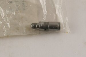

My latest difficulty discovered this evening is NOTHING by comparison… But I do so much appreciate being challenged by problems that can often be overcome by NOT giving up at the first signs of difficulty and throwing my hands up in the air! Nope…. Never gonna happen… because I will invariably think my way out of these difficulties!
I was looking over the Engine Head this evening in greater detail in the top area from front to back of the Camshaft and Rocker Arms Caps...and I noticed something disturbing on one of the Intake Camshaft Lobes between Cylinders 4 and 5.
You can see centre-left in “The Problem” image above that while all of the other Camshaft Lobes have very little wear if any...are extremely smooth and shiny...and show consistency from nose to aft along the Valve Train that they have been very well behaved because they have been very well Oiled during the life of this Engine. But "The Problem One" is different… it appears to have some Scoring and Galling that can only be explained by one or more of the following possibilities:
(1) The surface of the Camshaft Lobe was defective and got worse with continued engine rotations.
(2) The Lobe is in good shape… but either some Babbitt Material or Particles of Aluminum are stuck to edge of the ogive shape of the down ramp... with indications of juttering, vibration or bouncing due to its presence resulting in its wave-like pattern and odd distribution along the hardened surface.
(3) The HLF-129 Valve Lash Adjuster has Fractured and Failed and has been making Damaging Camshaft Lobe Contact.
(4) The Valve Rocker Arm has Failed and Fractured and has been making Damaging Camshaft Lobe Contact.
(5) The Oil Feed Inlet leading to the HLF-129 Valve Lash Adjuster is either clogged or jammed up with some debris...obstructing the proper flow of engine lubrication.
(6) ...or ANY combination of all of the above...
The fact that this Engine is mounted on a Stand makes what follows very EASY for me to do (and of course memorialise in Digital Images to post back here)...and it also gives me the chance to finally decide on whether or not I will continue tinkering with the other necessary repair of the #6 Exhaust Manifold Bolt Hole… or simply pull this Aluminum Head off of the Motor and replace not only IT with a Brand New Engine Head sitting in my storage room… but include installing a Brand New Oil Pump and Brand New Complete Timing Chain/Tensioner/Guides/Intake Sprocket and Brand New Delphi VVT Actuator Gear and Crankshaft Timing Gear as well.
However… if it turns out that this repair is well explained and mediated down to just this one problem (I have Ordered the Kent-Moore Tool for $15.00 along with a pair of GM AC-Delco OEM Replacement Lifters and one HLF-129 Valve Lash Adjuster for modest cost via eBay)... then I will continue on as before with the mechanical tidying up this engine. You should know that this repair can also be done; albeit… less conveniently... while the GM Atlas 4.2L Engine is installed in the Trailblazer, using the same Tools, Replacement Parts and following the “How-To” Manual Instructions as follows:
The use of the Kent-Moore Valve Spring Compression Tool is well explained and Illustrated at the link below where the Full Repair Manual can be easily downloaded and viewed at Page 177-of-677 Pages here…
http://www.manualslib.com/download/1101982/Chevrolet-Trailblazer.html
...but for the sake of convenience for this immediate posting, I popped some screen prints of the Manual as JPGs & PNGs so you can see how it works… demonstrating that without the need to either pull the Engine Head or endure the Nightmare of have to Remove the Intake Camshaft… this tool provides the means to replace both the Rocker Arm(s) and HL129 Valve Lash Adjuster [Tiny Push Rod(s)]:

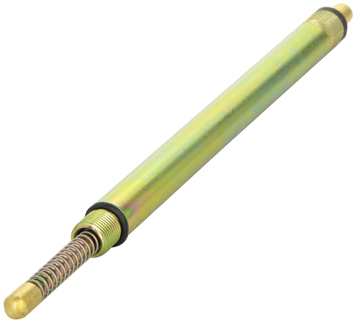

In looking over this speciality Kent-Moore Valve Compression Tool...
kentmoorevalvespringholder2-jpg.78356
...it occurred to me that they left one important feature out of its design in the form of a drilled out area in perfect alignment with the Spark Plug Hole... and that way the tool shown below could have been used simultaneously to confirm that while the Intake Camshaft is resting on its Base Circle, the TDC Tool would be able to confirm that the piston had also descended low enough not to have the Artificially Compressed Valve Spring from allowing the Open Valve to strike the head of the Piston. I will be using this very same TDC-BDC Tool before I attach the Valve Spring Compressor and will make no modifications per se... its just an idea rattling around inside this Old Coconut of mine:
https://www.amazon.com/Innovative-Products-America-7886-Indicator/dp/B000FMSU9Q/ref=sr_1_1?s=automotive&ie=UTF8&qid=1473943025&sr=1-1&keywords=Innovative+Products+of+America+7886+14"+Long+14mm+Thread+Top+Dead+Center+Indicator
Also... I just want to add that I am making this post as much in earnest ...just to get me away from this dreadful Post Count Number... and I must confess to being very "numerically superstitious" about certain numbers...and unfortunately... no amount of intellectual rationality has ever been able to change my feelings about this problem. Please indulge me this distracting defect... among all of the others that I suffer from.
