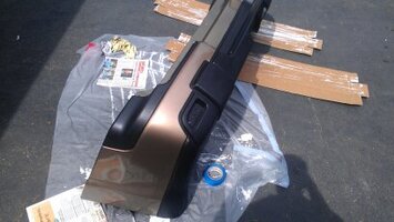

Used bedliner to paint the rear bumper plastic and doing the other trim as I have time. Also replaced the rear swaybar endlinks.

^^^ Looks good, what type of bed liner paint did you use?
It was Rustoleum I believe. I just scuffed it up with a "medium" sanding pad (probably about 150 grit or so) and washed/scrubbed with TSP. I used 2 coats, about 2 min apart, as the directions say.

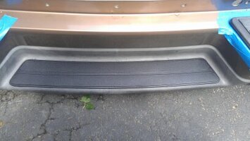

I tested it on a small area first, which shows the difference:
