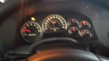

Drove it to work today but on my way saw the dash light up.20170108_071455.jpg
I guess the steeper went to sleep. Lol

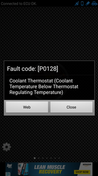

Plugged in to the odb2 to verify that and of course it's exact what I thought as well as the thermostat is shot.Screenshot_2017-01-08-07-32-44.png
As I'm driving it get pretty low at about 150 degrees which is scary low for an operating temp.
Quick question for you guys should I be purchasing a temp sensor just to be on the safe side? My voy is an 08 and I didn't change it out the last time I replaced the t-sate which was less then 2yrs ago.
With the earlier models, we would recommend replacing it since it's right there with the thermostat. Since yours is in another spot, I'd leave it till it does die.
I'm going to pick one up just to have a spare in the parts bin. $18 @RockAuto works for me.:2thumbsup:

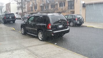

Abandoned it up at my cousins house on "ice hill" until next week. :sadcry: I drove up, lost traction, and got hung up 3/4 of the way up the mountain. Got to the top(with assistance), stayed the night, then had my cousin drive me home in his gmt900 with tire chains.

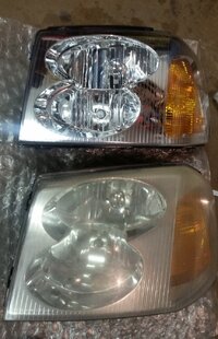

Replaced both headlamp assemblies, one had a broken height adjuster, but both were in sad shape as far as clarity, I've done the restore on the lens before but it's time to replace.
Quality seems good, not sure where I picked up my last headlight housing but these new housings seem to have the correct wire size.

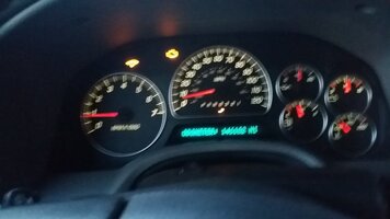

Combination of city and highway driving while running some errands. Kept an eye on the tranny temps to see if there's much improvement with the aux cooler since the weather is a little bit warmer. After about an hour of driving, and the engine pretty much pegged at 200, I snapped this on the highway coming back...
Meant to grab another pic after stopping at a few red lights, but forgot to. :duh: Quite a nice improvement over stock, which is usually around 175-180 after that much driving. :thumbsup:

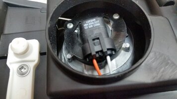

Waiting on the mailman to drop off a new 880 HID bulb for my fogs...lost one the other day and am hoping that's the problem. I don't have a spare bulb (which I should) and couldn't be bothered moving them around just to test.
Well, that wasn't it. It's the plug on the end of the factory harness. Summit has them in stock, so I'll pick one up some time this week.
