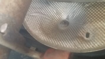

Solved one of my voys annoying rattles. Muffler heat shield came down on the muffler 1 washer and done. Although there are another 2 that I didn't get to but it will do for now.uploadfromtaptalk1442072113746.jpguploadfromtaptalk1442072130913.jpg

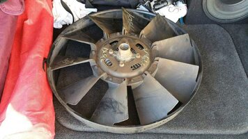

Also ordered a fan clutch with blade for $100 from a local salvage yard. I'm hoping to put a stop to the jet engine sound under my hood.[emoji120]
Drove it to work today. Mine has the opposite problem - the fan barely spins half the time and the SES light keeps popping on for fan under speed lol.

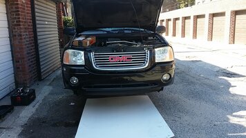

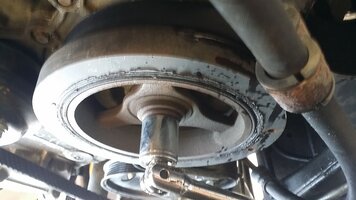

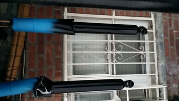

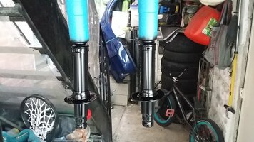

Took her to pick up my used clutch fan. Looks like I'm going to be busy on friday. Fan clutch, motor mounts, shocks and harmonic balancer. Don't bother calling I'm going to be up in this envoy like white on rice. Lol

Forgot to post pics. uploadfromtaptalk1442370944034.jpguploadfromtaptalk1442370953624.jpg

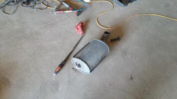

Said goodbye to the resonator. I don't know if it was because my Sawzall blades are worn or what but cutting that thing off sucked.
I'm thinking it was the blade cause I had a spanking new one on my sawzall and it cut right threw with no problem. It did vibrate a bit at first but I shoved the new piece of pipe I had between the muffler pipe and body of the truck and had my brother-in-law hold it while I cut threw.

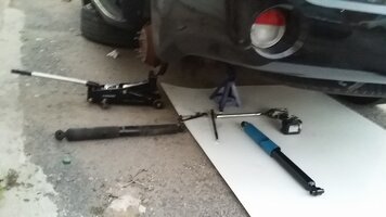

Since I got alot to do in the front end of the envoy tomorrow I decided to put in the new rear shocks.
Hmm just a heads up I have a life time warranty on the old kyb shocks. I think ima going to drop by and switch them out. If anyone wants to go that route with the kyb shocks let me know. uploadfromtaptalk1442534629082.jpg
Dangerous jack point, js. At least you're using jack stands though. Good idea on the old shocks lol.
At least he's got a wheel under there too
Not really. I had a jack stand on the frame , jack stand on the rear end,tire under the frame. I just used that jack to hold the rear diff from coming down and stretching or f - in up my brake lines.

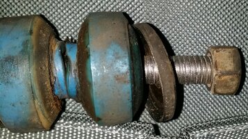

My moog sway bar end links went to shit. What a waste of money didn't even last six months. Decide to go with energy suspension. They worked great on my 1969 camaro rebuild. uploadfromtaptalk1442631791503.jpguploadfromtaptalk1442631924663.jpgAnd 1 more pic of spring removal. today.uploadfromtaptalk1442631947208.jpg
