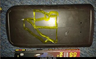

paulcmartin said:
I need to fix mine, but the plastic piece in between the top and bottom layer has broken out in shards. So the whole top sags. I was contemplating filling it in with shaping foam or something else until I can just get a new one.
It was exactly what happened to mine, and I'm pretty sure to everyone who got it broken. What you see marked in yellow was the ~7 pieces I had on mine. It was big hole with kind of like the shape of Texas:
I sanded the edges of the pieces with the dremel because it was too hard to line them in the right position, because they broke while bending. Then glued the pieces with super bonder, and then reinforced the back.
If you are looking into a replacement, they are very abundant on ebay.

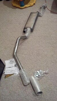

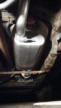

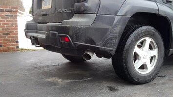

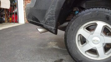

:iagree: Maybe a comment or two on mpgs after first tank or two? Love the exit look.
Yeah I'm curious too. I see it has 2.5" pipe and I've read stock is 2.75". Can you confirm this?
Yes, it's all 2.5" with a 3.5" stainless tip. I didn't measure the original pipe, as this is all new, and all fit together nicely.

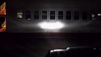

Found out tonight that my auxiliary lights (hella 500ff) give me the ability to summon the batman.
Batman needs to bring his carpenter's belt, whoever decided to install the windows that way is a strange one.
