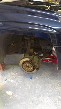

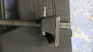

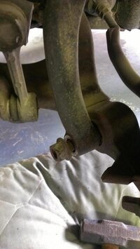

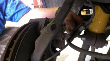

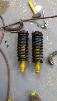

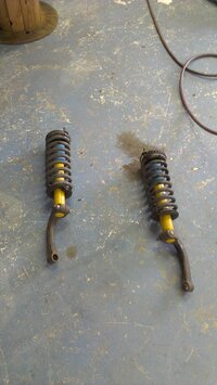

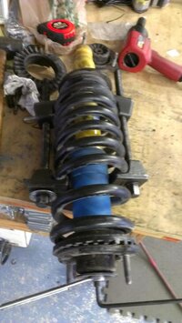

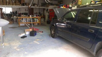

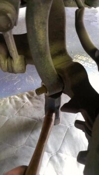

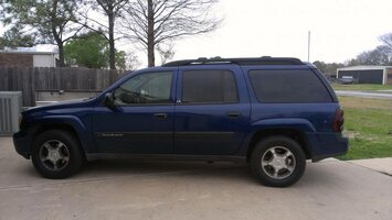

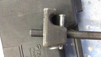

Well the parts came in a day early! Got the struts redone with new upper mounts and new moog 81112 springs. It seems like the ext actually have longer springs stock. From what I've read the standard freesprung length is 15.5 in but mine were about 16.25. The new moogs are a bit stiffer and added almost the lift I wanted but not quite. Least its nothing money can't fix LOL. Oh well lots of time and trips to the autopart store cause they gave me a broken spring compressor. Took enough pictures so I can make an article this weekend. I'm up to 34 5/8 inch on the front fenders from 33 1/2 so basically a 1in gain. A topic ive seen a lot is how to get the knuckle off of the joint at the lower A arm, I posted a pic of how I hit it with a sledge hammer a few times to get it loose. It takes a few good swings with a 3-4 lb hammer but it works. Be sure if you use this method to leave the nut on a bit to keep from hitting the threads!
