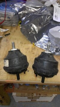

With some expertise from my dad we changed the motor mounts today. I can say it has been an adventure trying to get the parts ordered and shipped. Job was pretty easy and the reward is worth it. It feels so smooth now and you can barely hear the engine running. On top of that it even decreases some noise while driving since the engine does not move around. One thing I did to ease the install was to cut the top non threaded portion for the drivers side mount as shown on the left in the picture. Come to fund out the top part of the old passenger side mount was pulling out.
