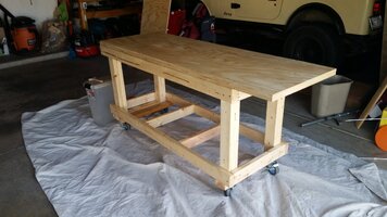

Nice bench! One of my spring time projects is going to be to build an outdoor workbench out of 4 x 4's and 2 x 6's. It'll be made of pressure treated wood and bolted to the patio with concrete anchors. All that's out there now is a plastic outdoor patio table. Not real reassuring when you have something heavy that needs to go on the table.

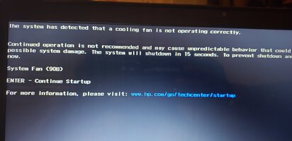

Sit down on the couch to relax, grab my laptop and it's off. I leave it on 24/7. Go to boot it up and get this screen.
The cooling fan I replaced last March, is already dead. WTF! :hissyfit: of course the warranty period was only a month cuz I paid $10 for it. Debating if I want to get another one, or just buy a new laptop. Decisions, decisions. :undecided:
Decided to order another cooling fan for the laptop, that will arrive Saturday. At least I know approximately how much time that will give me. Had a few laptops on my wish list from November, cuz my current one is over 10 years old, so I'll review those more closely over the next month or so and likely pull the trigger. Working from home today, so turned my attention to the toilet issue. Poured a bottle of Draino down the tub, let that marinate for 20 minutes, but no joy. New idea... Grabbed a few buckets, and went out to the rain barrel, pulled 10 gallons out, and poured them into the tub while the shower ran. Figured the plunger wasn't working, as the pressure was releasing towards the tub drain. Adding a bunch of water weight on top of the clog (as well as in the tub drain pipes) would put more of the force from the plunger where I wanted it. After maybe 15 seconds of pumping, the tub started gurgling, and the toilet flushed as normal. Crisis averted! 😌
