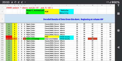

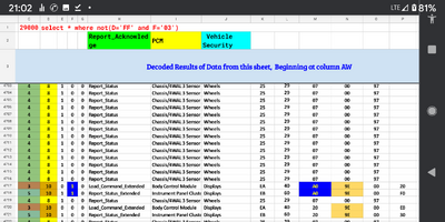

While the PCM may not control the security it absolutely participates. It is a message from the PCM that ends the 10 minute timer. I have recorded the class 2 data stream of a few relearns in their entirety and have been studying the data. Here in the screenshots is seen the moment when the PCM sends a priority 1, type 8 SAE J1850 message to the primary ID of 'Vehicle Security'. That message is acknowledged by the BCM which waits 15 seconds then sends a load command extended to the IPC to set the security light firstly to solid and then to OFF. (during a PCM relearn the BCM doesn't wait the 15 seconds, it shuts off the security light immediately)

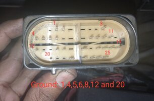

greetings to all friends. Thank you very much for all the help. We could already start the truck for now I have a problem with a short in the data cable of the ebcm. the truck turns on when both connectors on the ebcm are disconnected. but when delivering it, it turned on with the ebcm connected, after manipulating the connector that is next to the fuse box, the continuity of the ebcm data cable was presented. I upload this image with the information of the measurements.
it was necessary to change the ignition key module, bcm and pcm, all from the same truck and so we managed to turn it on
I am going to have a look at my truck because I cannot remember which side of that connector has the male pins.
If the truck starts and runs OK when the ECBM is disconnected that at the very least suggests the short is in the EBCM module.
This agrees with your tests of much earlier that found the EBCM shorted.
If this is the case then the wiring may be OK,, excepting there may be something loose at that large connector you pictured.
When you recieved your truck back from the shop were there any dashboard warning lights or check engine lights a tivated?
the female pins give direction to the ebcm and the male pins give direction to the cabin. I checked at night anyway, I could be wrong thank you mister baker
only the "check engine" light was flashing. for the rest, do not observe anything irregular. but my doubt is because they turned it on with the connector connected, with both connected. then remove the battery I began to organize a bit the connectors and wiring. then when mounting and connecting the battery, I appeared again the "unknown driver". I checked the fuses, I didn't sleep at all and the next day on the sp205 I measure continuity to ground and it gives me the whole package to ground. I disconnect the ebcm and again I have "driver 1" and turn on the truck
All these tests indicate that there is a defect in the EBCM module
