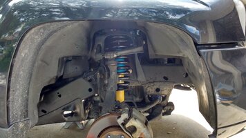

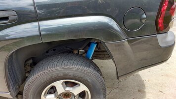

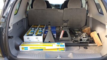

With having today of and Monday paid holiday I thought today was as good a day as any to tackle my shocks.
I started with the fronts since I knew that was going to take the most time. Surprisingly only ran into a few snags. Mainly not having the proper sized pickle for to back off the yoke from the LCA was the problem. But a quick trip to advance auto solved that problem.
Sorry I didn't think to take any photos till it was already in. Also learned the hard way that over tightening bolts make them snap. Was attempting to torque down the ball joint pinch bolt and just snapped it like a twig. So ran over to the local Chevy dealership and surprise surprise the parts department closed an hour early :hissyfit:. Man was I not happy. As I leaving the dealership I remember that when I first bought the TB, I bought an upper ball joint that I never used because I just never got around to it. Sure enough replacement ball joint had replacement pinch bolt :woohoo:.
The right side went a lot quicker and a lot smoother with the knowledge of tackling the left side first.

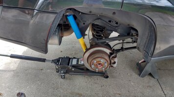

After buttoning up the front it was time to do the rears. Was able to relax while doing this since I knew from watching some videos on it, it would be simple.
After a quick test drive to return the pickle fork set, I can definitely feel a difference. The vehicle doesn't feel as shaky over bumps and corning seems a bit tighter and smoother. Also the noise inside the cabin has been reduced too. All in all I'm glad I went with the Bilsteins on all four corners. Now all that's left is think what else needs fixing ;).
