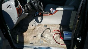

Here's where I have mine. It's been there since last summer.

1. It's a 2000 watt from harbor frieght. Pretty cheap but works well.
2. I used 4 gauge wire for both ground and positive.
3. No .... I just tapped into the fuse box under the rear seat and added a inline fuse. The ground I went straight to the seat bolt.
I hardly use it at all. My son get the most uses out of it charging all his gadgets and what not. I use it to vaccum. Lol. But it will always be there for when the time comes that I do need it. It has 2 usb ports and 2 recepticals.

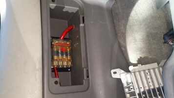

No power drop issues so far. the only tool I've ever plugged into it was my d.a polisher with no problem. I've been planning to get a new wire and attach it to my rear fuse block for my amps since I have 2 empty slots. And have 0 gauge power running back there from the battery. btw no need to run the ground all the way to the battery just keep it as short as possible to any body bolt on the rig. uploadfromtaptalk1442451982812.jpg

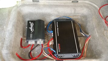

Yes sir. Might as well do the big 3 while your at it. We'll worth it. I've never had a issue with voltage drop or my lights dimming since the big 3. I'm also pushing about 2000 watts of amplifer and 5 farad capacitor just to insure no drop in voltage and to save th e battery. uploadfromtaptalk1442453996884.jpg I so have to clean up the wireing it's not working for me.
