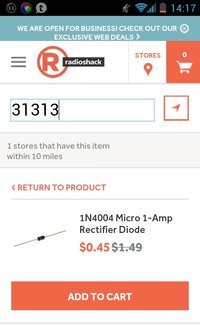

I can't remember what Lil capacitor is needed to do the quad beam mod. I would like to get that knocked out today. I think I'll go ahead and do my cluster today too. Probably way late tonight after everyone is already asleep. So no one is a PITA
Easier to ask than search.
I meant diode, but whatever I found it, and I know my radioshack has it

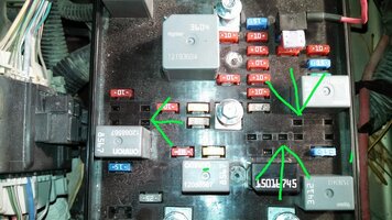

I swapped pins for quad beams... Nothing else needed
You did? Haven't seen anything going about it that way
I did not do it personally as I got it done by Regulator at one of first meets we were at years ago when I did not even think it was possible. he popped the pins and swapped them and they have worked since. Only issue is if you have brights on when you turn truck off, the lights do not auto turn-off
Oh okay, I wonder which pins he swapped

Pin swap on mine was under dash not in fuse panel.
I had kinda figured that.. But just throwing it our there since he talked bout the diode mod first.. And since if u follow directions in the article but don't install the relay the right way it won't work.. But using these pins everything works.

If doing diode mod.. I made a diagram to what pins to use. Just never got around to rewriting the article..
What mine looks like. Got both diodes isolated from each other via heat shrink tubing then got a piece of heat shrink over both of them. Silver stripe goes to the high beam relay. I used the wire to connect it to the pins, wraps around real nice and it's secure.
I haven't seen the old pin swap trick since I first got on the OS back in '13.
-btw, if you don't have fog lights, you only need one diode and it's significantly easier because you don't have to get 5 different things soldered together like I did when I done it.

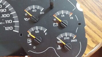

Finally put green LED strips in cluster
Buuuut RPM's, oil pressure, voltage, fuel, and water temp are all off.....which makes me assume speed is going to be wrong too.... And all these needles we're put to their marked positions. This is gonna be a PITA to fine tune.......FML
Any suggestions on corrections?
It helps if you have Torque, a Scangauge, or something else that tells you the same data. When I first did my cluster mods, most of my needles were slightly off like that too. Just took the cluster face off, and nudged the needles slightly.

I did change the position of the tach, but once I hooked it back up the needle jumped to around the 500 tick mark before even turning the key into the on position. So I guess I gotta turn all these needles a lot farther??

I have dash command, I'm not worried about where the voltage, oil, and temp gauges need to precisely be because I remember exactly where they are supposed to be from staring at my cluster all the damn time because of my wacky voltage. It's just a matter of moving the needles to the left far enough so that when I power the truck these needles start moving where they are supposed to lie. That's what I think is gonna be an annoyance. Because we're not supposed to move these needles while the rig is running right?
I seem to remember reading somewhere that before removing the needles you move them as far left as they will go, and make a little mark with some painters tape or take a picture. Then when reinstalling, line up the far left point again. I guess the steppers have lower stops?
Not really sure, I have never messed with mine on my truck. The Camaro uses something different for the needles (air core I think?) so when I changed them I just took pics of the needles when I turned the key to on, then lined up the new needles to the same position. Only had to tinker with the speedometer a bit after that.

Yeah I remembered that after the fact about moving them as far left as they'd go. All the needles are about a centimeter off from where they should lie when the vehicle is off
