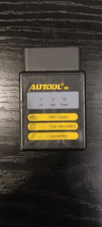

Thanks for your respond, the one i have is this on:
I've tested it on a Dodge and it's works fine live data is displayed pretty well however on my 04 Trailblazer it does work with key ON and readings the fault codes but when it turn it on it stays connected but no live data are showing even RPM everything is at 0 expect for the coolant temp, I'm using Torque Pro there's no faults in the adapter status, it did work for awhile hence the data I've provided in my OP but as of right now it refuses to work, any idea what causing this issue? my truck runs "fine" other than that intermittent P0171.
I'd really appreciate your input.

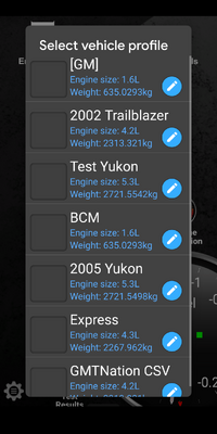

I have seen the adapters I have fail to properly switch between vehicles. The vehicle use different protocols and my adapters try the wrong protocol. That said, if your adapter is reading codes that suggests it has the right protocol selected for the TrailBlazer.
Do you have different "vehicle profiles" set up in Torque Pro for the vehicles you have? This can help to keep things straight when using Torque with multiple vehicles. I have several selections.
Also, within the vehicle profile is a setting to instruct Torque to use this protocol or that protocol for the specific vehicle in question.

I'm using this OBD2 scanner only on the Trailblazer, I've specifically set a profile for it as you mentioned and it shows the model, VIN and protocol.

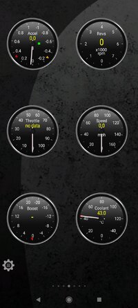

You're right about green dot it doesn't show at any of the gauges only on the speed gauge which isn't showing anything either.
This screenshot was taken with the engine running.

The "Accel" gauge in your screenshot is data from your Android device and as such does not require the OBD2 connection, so that explains why that dial 'works' while the others do not. Torque also has a Speed gauge that uses your Androids GPS so that is another dial that would not use the OBD2 connection.
You mentioned using the scanner on a Dodge, that made me think you had other vehicles that you used the scanner on.

I've tried it with engine running then plugging the OBD2 scanner same behavior. It shows that my obd2 scanner is connected on my Torque Pro app but the little car icon at the top keeps flashing and the app is trying different protocols to establish communication without succuss. As soon as turn the engine off and turn ignition ON it connects fine.

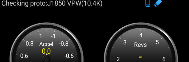

So how to you judge that it is trying different protocols??
If Torque is set to a given protocol, in this case SAE J1850 VPW it does not cycle through protocols. (I just confirmed this by monitoring the data bus while Torque was running)
If you mean to say that the car icon keeps flashing - that is just an indication that Torque is sending some standard messages in the current protocol looking for a response from the PCM.

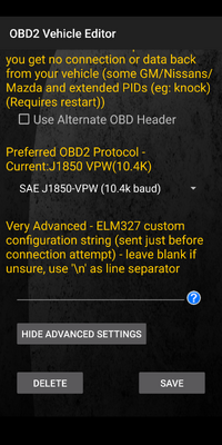

Does Torque override prior protocol settings in the ELM327 that may have been previsously set via ATSP h command? How about trying to communicate via the Serial Terminal app & reset to auto protocol selection (ATSP0)?
Edit: Or add ATSP0 as the ELM327 Custom Configuration string in the OBD2 Vehicle Editor above)
As users we don't get to see the communication between Torque and the OBD2 adapter. Would help a lot!
What I did was first set Torque to "Automatic protocol scan". Then I set up Torque to attempt a connection while I monitored on a second OBD2 adapter. In this mode Torque was seen to send 1 to 3 messages then I saw nothing for about 20 some odd seconds and then a message or two again followed by another 20 something seconds of silence. Resetting Torque to use SAE J1850 VPW resulted in the long pause disappearing and a more steady stream of messages from Torque. This I see as Torque not attempting other protocols but instead concentrating on trying to raise a response from the PCM.
Sorry i meant when i connect the scanner and open the torque app it cycles through protocols searching for the right one it happens when i turn on the engine.

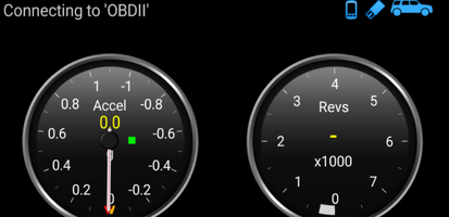

I'll send you what I'm seeing on the app with with the engine OFF ignition ON
I did some more testing just now and added to the data trove.
I already knew that Torque Pro can show the connection progress in the Dashboard view. I always start in the main Home screen so I don't often see that connection progress bar in the Dashboard view.
I was under the impression that Torque only tried the protocol that was set in the vehicle profile.
However, I just discovered that even if one chooses a given protocol in the vehicle profile, if Torque fails to connect in like 20 seconds or so it reverts to the Automatic Protocol Search anyway. At least that is what is displayed in the progress bar at the top of the Dashboard view. Is this what you are seeing?? The display at the top of the Dashboard view??

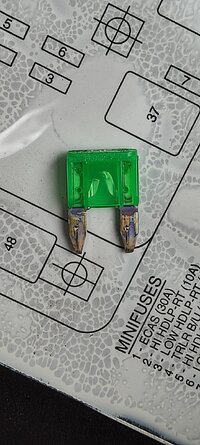

Just checked #19 fuse and look what I found!
It was blown I've used another 30A and it no longer disconnecting after starting up the engine... Thanks for the suggestion!

As @MRRSM suggested i found that #19 was blown felt a bit stupid for not checking with basic stuff first it's working now i turned the engine ON and it didn't disconnect and i can confirm that my obd2 scanner is receiving data however there's still some weird behaviors and massive delays I'll upload a recording of the torque app to see for yourself.

Well according to the service literature and wiring diagrams and my owners manual fuse 19 goes to a spot under the dash on the drivers side where it just ends, connected to nothing. It is meant for connecting up an aftermarket trailer electric brake controller.

however if you take a look at the fuse diagram provided by @MRRSM you can find fuse #19 for (Cigar Lighter, Data Link Connector (DLC) which is exactly what caused my issue.
The general motors documentation, including owners manuals, say otherwise. That is the peculiar thing here. This is the original owners manual

"What made the #19 Fuse FAIL?"
THIS Video from Duane at "RealFixesRealFast" is a Primer on How to Search and Find an Active Short:
