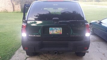

30 watt Cree LED reverse lights, oh yeah. Can't wait to pop these suckers in.

When it gets dark I'll see exactly how bright those reverse bulbs really are.
