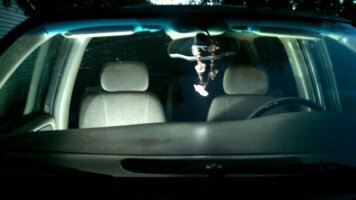

I got my lights today and I'm attempting to put them in........do I need to remove the metal pieces pictured below?
I removed mine when I put in actual 194 led bulbs because the bulbs wouldn't fit otherwise.. So u just left them out wen I did the panels and used small zip ties to tie them to the housing
Any chance you have a photo of how you tied them with the zip ties?

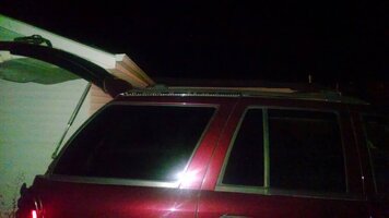

Just trying it out for now, I stuck it there and have a 12V powersupply for testing. I feel obligated to use them someplace since I have it lol. I might put it between the rear bumper and hatch with the left and right stacked. pretty big gap there that needs filled anyway.
It does fit nice on the rails, it just seems a bit.... too much
Although the gap is big, from ride height, you don't see all that much due to the bumper step pads on the sides. I ended up placing mine too low the first time I put my bar on, had to yank it off and reapply double sided tape to put it back on higher up.
