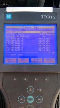

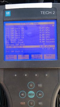

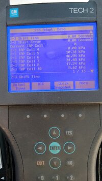

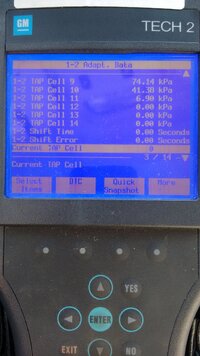

Pics of data from before the reset

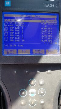

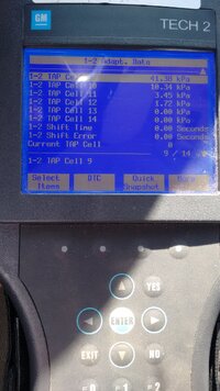

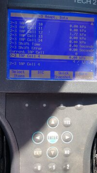

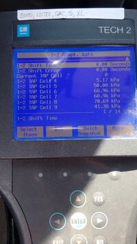

Pics of data after reset and driving around for a week but with no trailer/load on.
JayArr
Sep 24, 2018
544
Mission BC Canada
Fist of all, I don't see TAP cells 15 and 16, I also don't see cell 9 on the 2-3 screen
I checked after clearing them and I had all zeros after the reset.
My TechII is a knockoff
50 kPa = 7.25psi.
A lot of the 1-2 numbers didn't change very much, a few are a bit lower and a few are a bit higher. Cell 4 dropped from 53 to 4, 9 from 74 to 41 and 10 from 41 to 10. 6/7/8 all went up slightly. This is the shift where the band is engaged by the servo, maybe I need new springs in there? Maybe the new band hasn't bedded in yet?
The 2-3 numbers are sure a lot lower. I wonder if doing the Sonnax ream and sleeve of the PWM valve raised the pressure so that the TAP doesn't now have to turn it up to get a decent shift into third.
I now wish I could get a set of TAP data from a new 4l60e to see if my 1-2 numbers are a concern.

I explored a little more about the absent 2-3 TAP Cell 9 and found my Tech 2 (clone) also has this missing. I experimented with using other year selections and they also showed no 2-3 #9. But here it got really weird. I know the memory blocks where the TAP values are read by the Tech 2 and in the 2006 PCM I have there is a value for 2-3 TAP #9!! But the Tech 2 does not display it!! Why would a PCM update a TAP cell if it were not used?? Is it a possible bug in the Tech 2 not displaying this cell?
